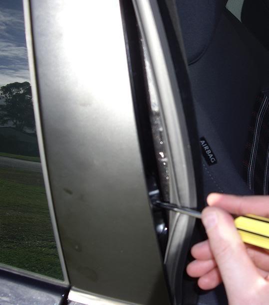

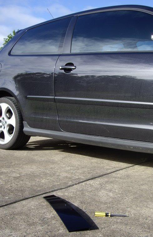

                  Right Completed, all in all a 5 minute job, plus 10 minutes shouting and swearing when I lost one of the screws into the depths of the door.
                  Pretty easy after all. Grab one dirty polo, a small Phillips head screwdriver and a gloss B pillar, plus one "tool" and away we go:
                  Wind down windows, Pull back seal and Unscrew (and DON'T Loose it!)
                  Slide out the old one. and Slide in the new one and screw in (trying to avoid putting dirty fingerpronts all over the new gloss pillar):
                  Push back seal, wind up window, check then close the door, leaving a big fingerprint mark on the new gloss pillar, that you've been trying to avoid doing
                  Hope this helps the new Gloss pillar owners. I've got some more detaid ones if anyone is as hopeless as me!
