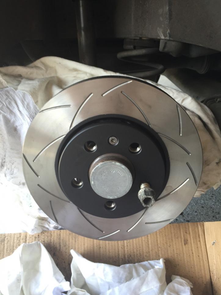

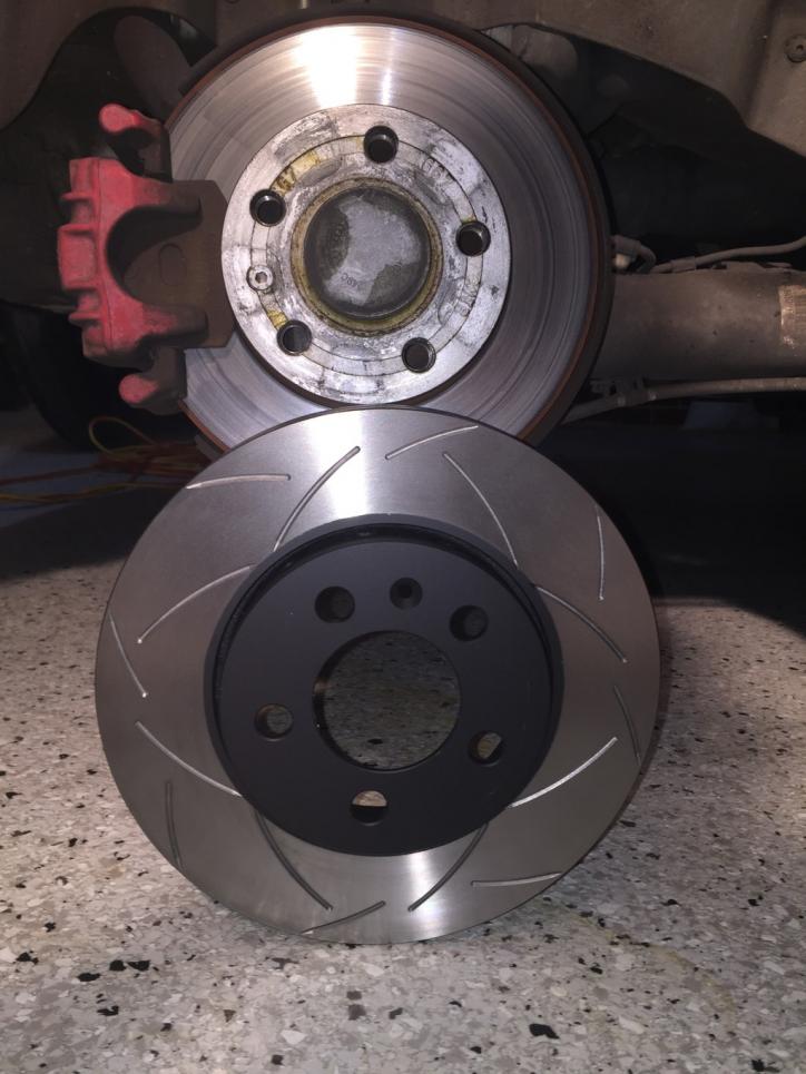

The rotors and pads arrived yesterday so I had a poke around to see how this is all going to fit up.
I was a bit worried at first about the caliper offset
But then I checked out the rotors and noticed a few things.
Firstly they are heaps wider than the oem items. Standard is 9mm and the 256mm items are 22mm.
The offset of the 256mm rotors also appears different, even after you take into account the different thickness. This is what has me less worried.

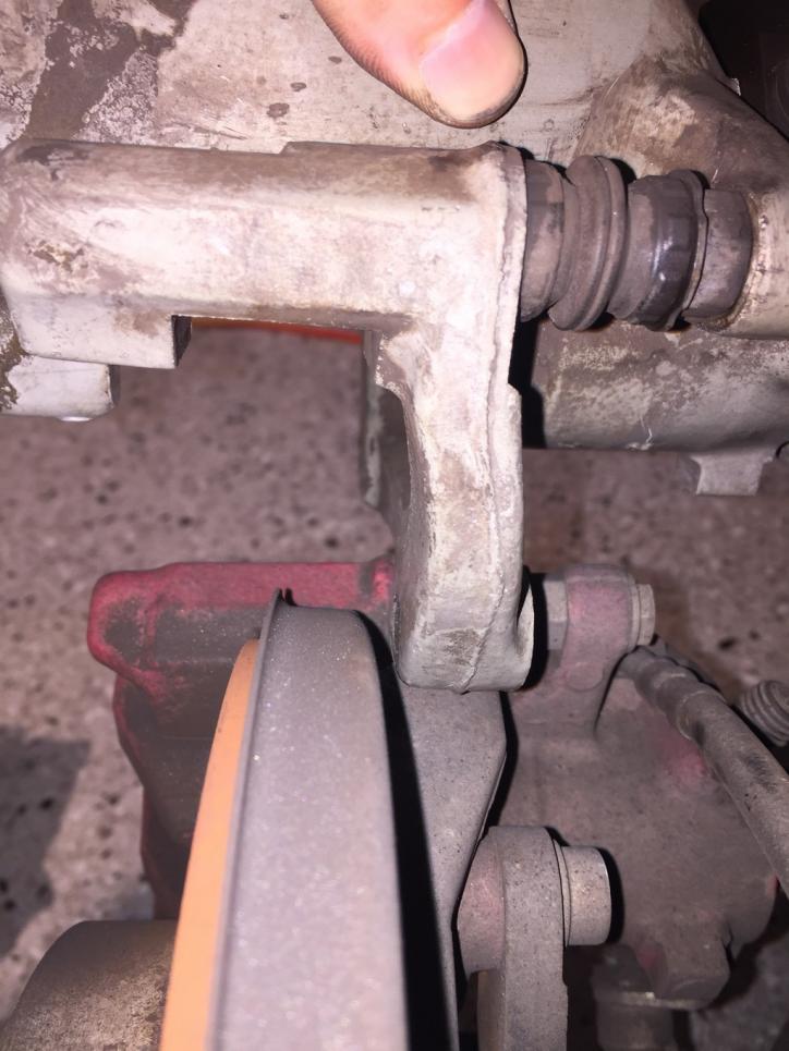

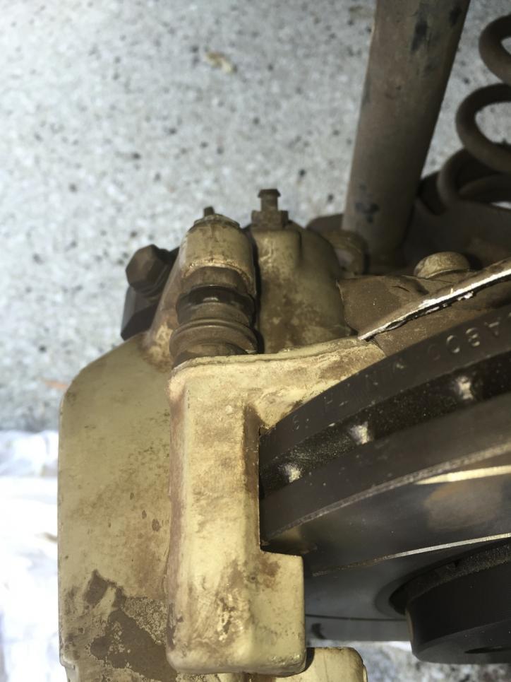

Well the good news is that this is a dead easy job. Taking my time I had the old gear ripped off, cleaned, tin trimmed and the new stuff fitted up on one corner in less than an hour.
The bad news is that the caveat that applies to the bora 4motion gear, as mentioned early in the thread, also applies to audi s3 carriers too.
To fit I would need to space the carriers at the hub and take a bit out of them to clear the rotor. I was speaking to TDIfan about it at the dyno day today and he was spot on.
Rotor clearance
At the hub
Hopefully Gavin has some bora V5 carriers kicking around!08 9n3 Polo GTI
