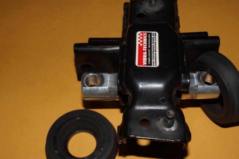

                            I would like to jump in here to share something that I found recently with the vibra-technics left gearbox mount, I'm sure I was the first to get these mounts in Aussie so I had the earlier mount from before about two years ago which were a sh*t design.
                            Only found this fault when I went to bleed the clutch which is done after removing the air filter box, battery & the left engine mount.
                            I had been chasing this clunking noise for sometime & then wallah.
                            I've been in contact with them & all they would tell me was that the earlier design was redesigned with no sympathy to my case.
                            So I had a good look @ the original mount & found it to be much better than their earlier model.
                            If ya a look @ the shiny metal part, you'll see what I mean.
                            The round collars done nothing, I wasn't too happy, but found the standard one great.
                            The right hand mount is a different story, much better.
                            Hooroo.
                              damm the looks like a weird design the new design looks to be alot better and alot of people say good things about them hope they
                              work out good.
