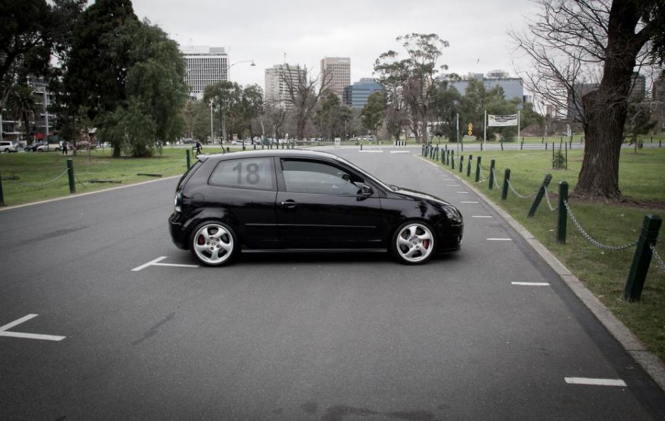

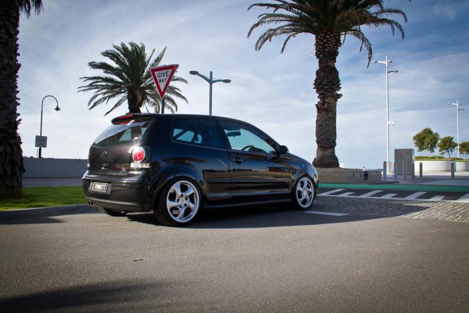

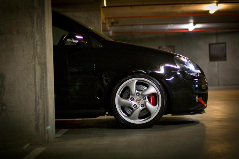

                      35mm adapter on front
                      15mm adapter on rear
                      Think the wheels were 17X7 and 17X8.5 with a 205/40 and a 215/40
                      They looked so good someone decided to literally steal them off my car
                      MODS- TOO MANY
                        Awesome man thanks, obviously they were 5x100 to 5x130 adaptors also?
                        Oh really man, that sucks big time!
                        We're those wheels of a particular model? They look different to the twistes I've been seeing
                        Sent from my SM-N9005 using Tapatalk
                          Yes they are adapters and Boxster S wheels
