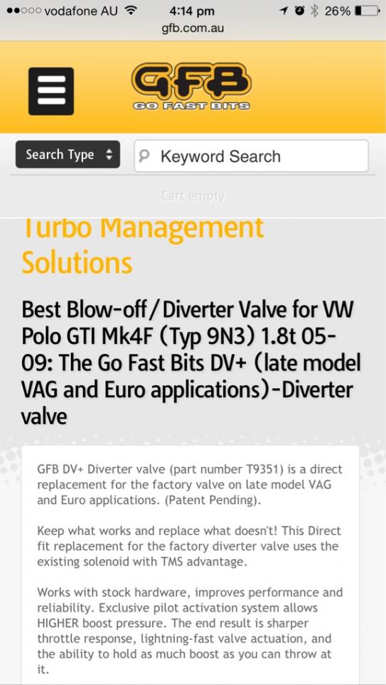

    Howdy. I bought one of these diverters last week as I have read good things about them.
    I read online they are installed on the turbo housing but I can not for the life of me see where? I could probably see more if I dropped the drive shaft but on there web page it says it's a really easy install so I wouldn't imagine if need to do this? Only other thing I thought was maybe there listing is wrong and I need the diverter that sits up on the TIP near the n75? Dunno..?? Any help would be greatly appreciated as I can't find anything online specific to the 9n3.. Thanks

    Sounds like the wrong one mate. The DV on the Polo goes into the TIP from the turbo outlet pipe.
    Gavin
    edit.
    It's for the MK5 GTIs and up. So see if you can get a refund and buy a different one.
    Forge 008http://www.forgemotorsport.com/content.asp?inc=product&cat=260301&product=FMDV008

        Shattered! Yeah I'll ask for a refund because the add says its for 9n3 Gti. Thanks again for the help

          Yeah, advertised for the 9N3; sadly no go. Went through this recently, got my hopes up, only to be dashed.
            That's the solenoid ones for the 6R gti's. Won't work

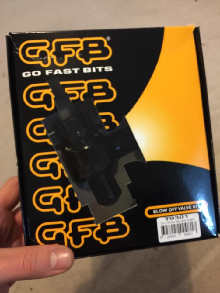

              I've got a GFB DV on my 9n3; the one you want is a t9301. I got mine through an australian website here dv+ T9301(25mm Bosch diverter valve replacement)- BOV | Turbo Chargers & Parts | Spares Box Australia . It's very nicely made, is designed to run the "wrong" way around which works better, and in three months I haven't had any dramas (nor expecting any).

                  I just looked on the GFB website and it even says its compatible with the 9n3 on there.. I can only imagine how many people would have gone through this. I might email them directly but I doubt they will listen.

                            That looks more like it!
                              Yeah I'm stoked I finally got it! I'm gonna put it on this arvo I've just been pre occupied with customising my dash so haven't had a chance to get it on
