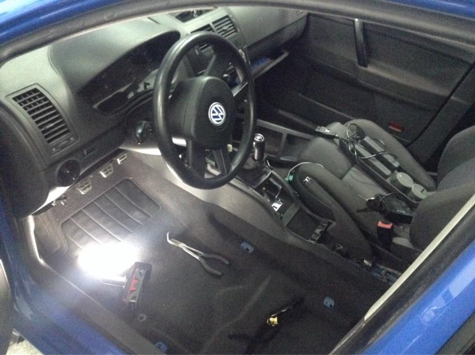

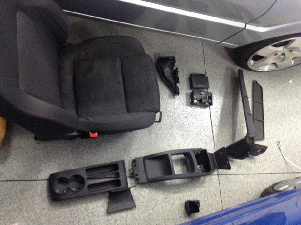

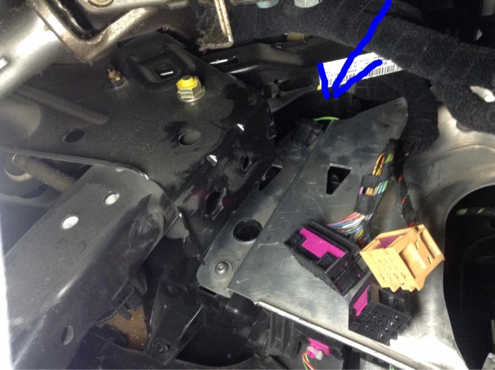

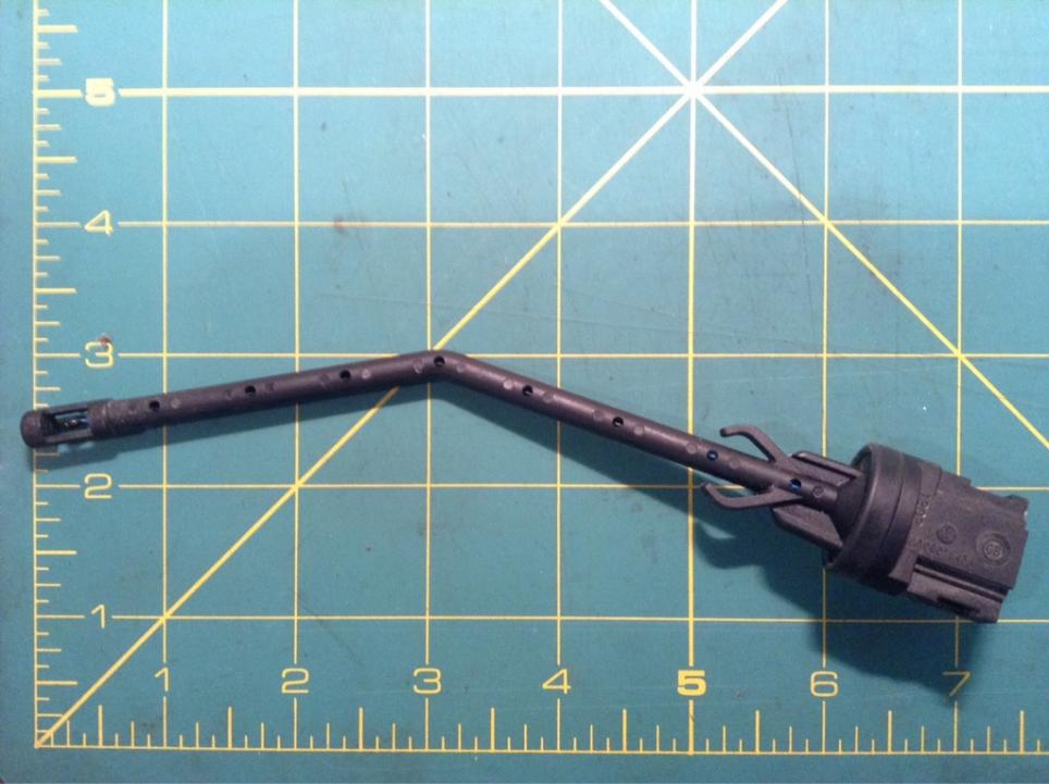

I had a code for G263 open/short to ground and my compressor was always on but no cold air ever came out. I did some searching around and found that a couple Audi A2 owners had problems with it where it had a similar symptoms; no/little cold air output but the compressor was always on. Just curious if any of you have had this issue before. Its not fun to replace because its way up under the dash, I pulled the lower dash trim, center console trim around the shifter and e-brake and the driverside (left) seat so I could lay down under the dash. I managed to get it out in under and hour and thats with cleaning all the dirt and out from under the seat and center console.
