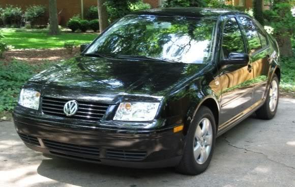

    Does anyone know if the Polo GTI and the Jetta (pictured below) share the same front end chassis design? The engine bay appears to have the exact same layout with the 1.8T.

        The bumper bar fittings behind the bar are different. So whilst the FMIC itself would be fine, you would most surely have to redo all the pipework to and from the FMIC.
