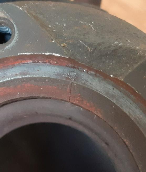

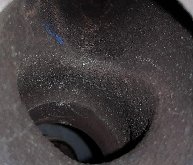

However - i never posted what the end outcome of all this was.
- Mechanic pulled the turbo off, and found a cracked exhaust housing.
Replaced the turbo, problem solved.
Im sure its not what you wanted to hear, but figure i'd give some closure on the matter.
the mechanic also installed the forge wastegate actuator - despite my asking him not to, and of course didnt tension the wastegate actuator correctly.
hope it doesnt turn out to be the housing as it was in my case.
