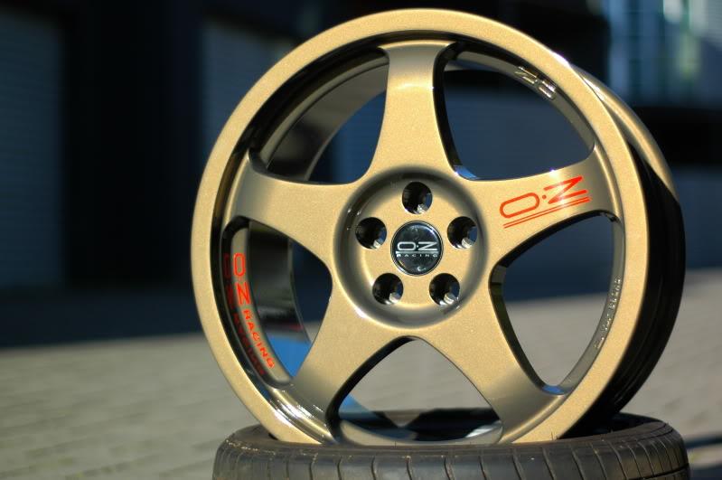

          I've got some OZs in 17x8, ET35 up for grabs. RE002s in 215/40/17, still have some life left in them
          Make an offer..

              Then Stu puts up a very nice set of wheels of a colour that would suit multiple coloured vehicles & are a good fitment for the 9N3 Pog. which is also open to an offer.
              Make an offer..
