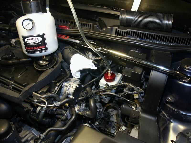

      When I changed my rear rotors and pads after buying my Polo two months ago. I bled the brakes with a motive bleeder without any issues. I didn't introduce any air into the system and my main reason for bleeding was to change the fluid.
      Here is a picture of the motive bleeder. My wife was happy to buy it for me after years of having to pump the pedal.
