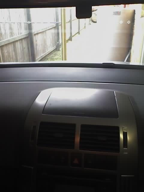

                  This is what the cubby looks like:
                  Sorry the pics aren't great ....
                    That is so much better than the open tray...gunna have to get one in the near future.
