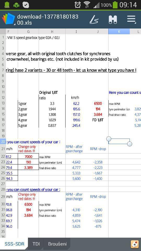

              Ok thanks to Jmac for counting the teeth on the Polo's HWY box which are 62/17. So checked that against the spread sheet from SQS that Njay posted which says we have a final drive of 3.647.
              So they also say the stock gear ratios are
              But the speeds are calculated from a 3.684 final drive. So will this just affect the speed at certain RPM? And if so will the Polo's final drive make these speeds higher being a smaller drive?
              Cheers.
