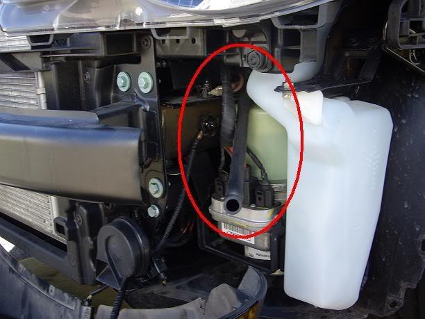

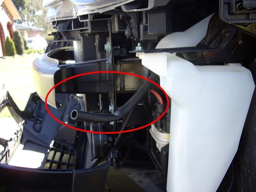

                    Anyone know what this mystery pipe to nowhwere does or is for?
                    Simon
