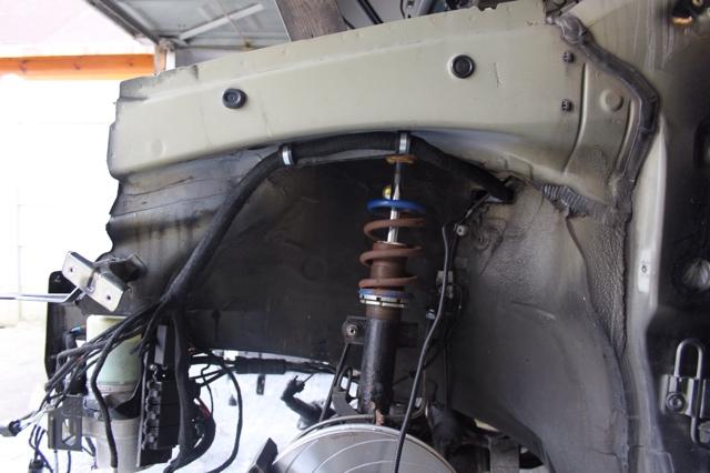

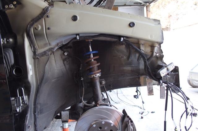

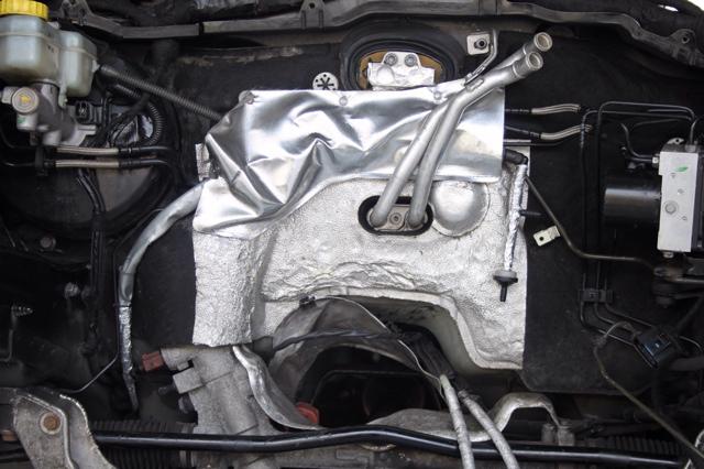

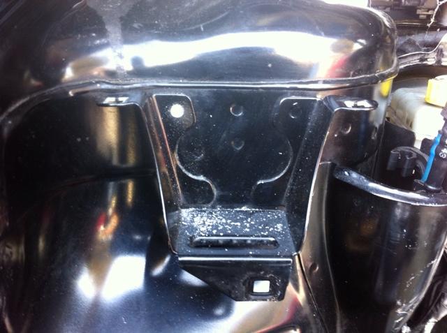

    Few more bits done today.
    Secured the loom to the body using some P-Clips and a rivnut tool.
    Here's is a better pics of my re routed Evap piping with the T piece to the throttle body and the 1 way valve before the TIP

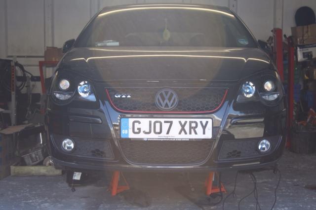

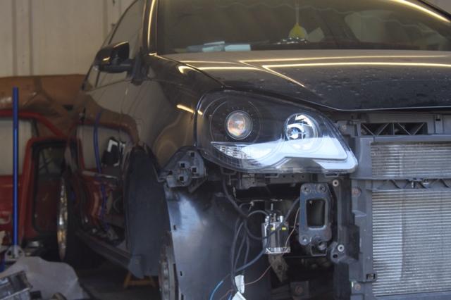

    Fitted the wings back on and test fitted the head lights and front panel to ensure the length of new wiring was adequet
    Next up car off to body shop (last weekend of April) for bay, wings, bonnet and front bumper to be painted the. I can fit the engine with my new head.

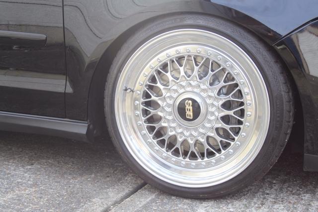

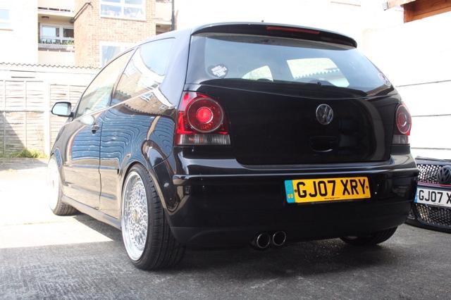

      Today I got the other 2 tyres I needed and sealed the wheels so will have the tyres fitted on Saturday.
      Also dropped of the head to be skimmed and aqua blasted.
      It's all coming together.

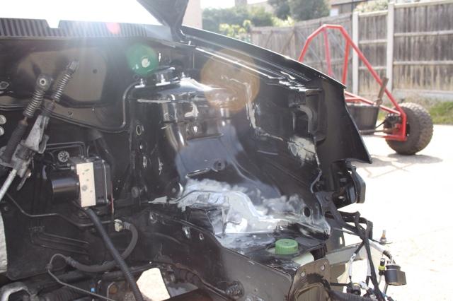

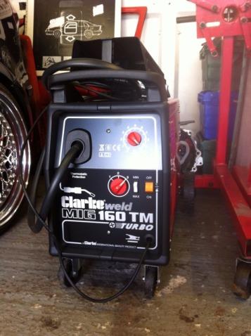

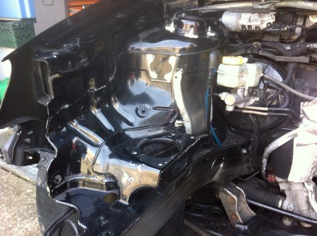

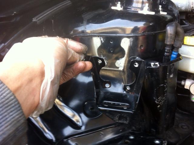

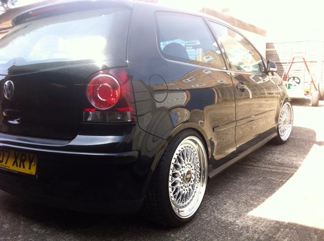

            Got a bit more done this weekend.
            Tyres fitted to the front wheels
            Also started on the bay
            Also got this. Just waiting on my Gas and I can start welding up some holes that I don't require.
            389.3 BHP Polo GTI

                            Been a little slack on the updates due to waiting for dates to come round but the time has finally come and car went off on Saturday for the bay to be painted
                            On the tow truck
                            Went down last night to remove the BBS and will pop back Saturday for some update pics.

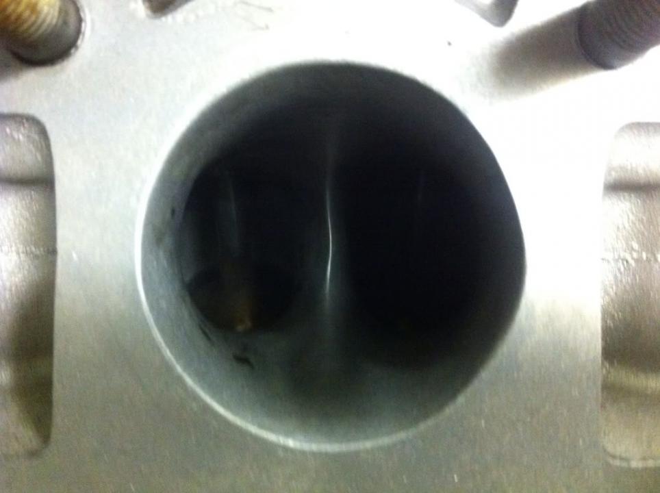

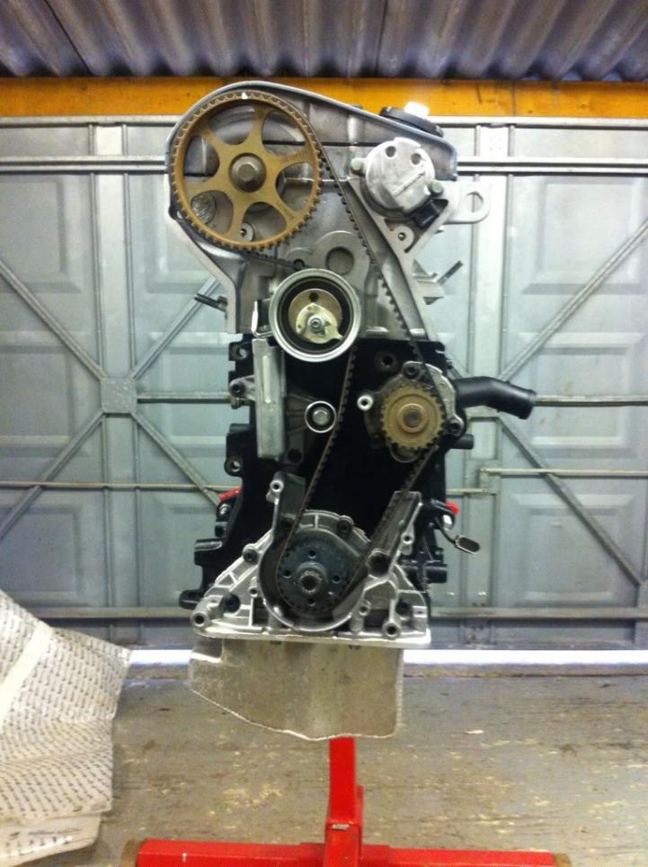

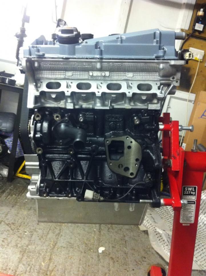

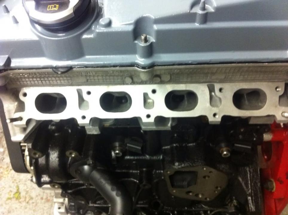

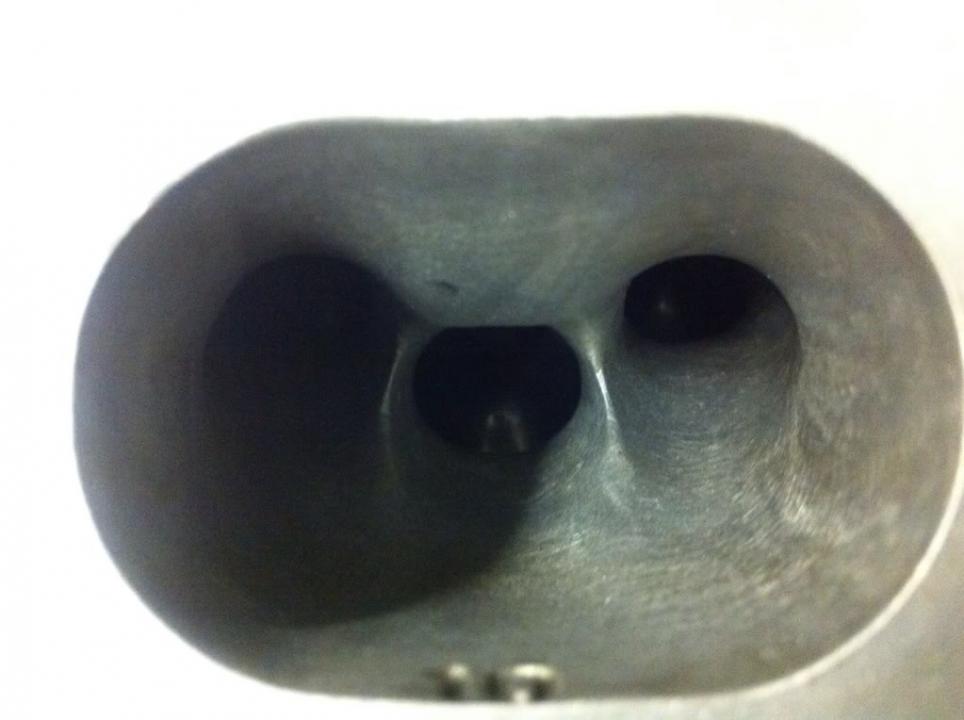

                            Engine has now been put back together with upgraded head. Although as with everything I do to the car this was not a smooth transaction.
                            I had the head checked over and there were many issues
                            Cams showing wear due to oil starvation
                            Various lifters were past it
                            All valves were not sealing due to not being seated correctly when originally put together.
                            Also while I was at it I checked how the block and there were scores in the bores due to grit from when the intake from when it was sand blasted and powder coated so got the following
                            Another block
                            Had the new block bored
                            all new bearings, head bolts and head gasket etc
                            So basically have a whole new engine ready to go in. Have bolted most of the bits to it so will get new pics but here are a few before

                            • #59
                              Oil starvation, not the first one I heard of..... Were the journals in the head ok? That's where mine was going/gone.
                              Something strangely satisfying bolting an engine together though I found.
                              Looking forward to the updates.
                              Gavin
                              • #60
                                Gavin
                                Journals had minor marks that were able to be polished out.
                                This is the problem buying second hand parts but at least I now know everything is new and perfect.
                                Block has new rings and bearings etc and head is all done fresh.
                                Can't wait to get the car back from having the bay painted so I can get it back together and start the running in process
