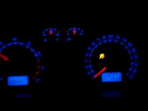

              This vid shows that high 5s/low 6s are certainly possible.
              • #22
                I doubt a polo with only a tune and running street trim would do high 5's. I'd expect it to take a bit more than that.
