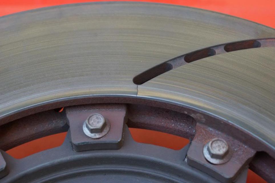

                          • #43
                            Hoyhoy.
                            While on here about brakes, whats the best lastest on braided lines & 2 piece 312 x 25mm rotors.
                            I'm not real happy with the Racingbrake rotor @ the moment, they work great & cool, but after less than 10,000km's
                            they have some probs, Racingbrake have offered half $'s replacement on the ring, but. but. but, me ain't too sure.
                            Hooroo.
                            • #44
                              Has that cracked through?
                              08 9n3 Polo GTI
                              Mods: heaps
                              • #45
                                Braaaakes
                                I'd steer away from drilled rotors entirely but that's just me. Look at slotted rotors if you must have some kind of surface detailing, Alcon do a good slotted rotor that doesn't remove much of the rotor face so you still get a good clamping area between pad and rotor.
