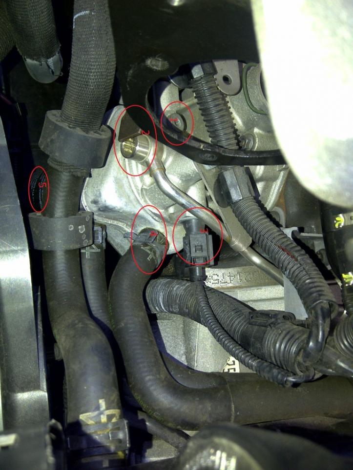

    Hi Guys,
    I am in the process of installing my gauges, however now that I have started, I seem to be a bit uncertain as to where to put the oil pressure/temp sendors. I took this photo, it is a picture of the top of the oil filter...
    could any one tell me what number 1 , 2 , 3 and 4 are.....number 5 is the oil filter (for referance).

    1 a blank
    2 oil feed to turbo, leave well alone
    3 pressure switch
    4 coolant pipe
    5 oil filter
    You can remove that blank and go in there. The other choice is remove the pressure switch and fit a tee piece. Make sure you get the correct thread for the tee piece. Also, getting everything tight and pointing in the right direction can be hard work.
    Can't offer you any more, having not done it recently.

        Thats the 5mm allen bolt i mentioned back when you were asking about the gauges mate. Sorry would posted earlier but not on here as much these days,
