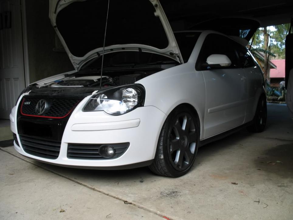

Picture of the virgin car

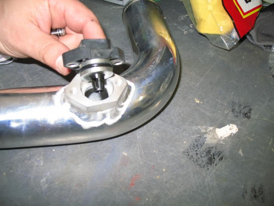

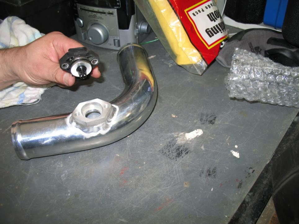

This is a picture of the Map sensor flange weldedd onto the alloy pipe

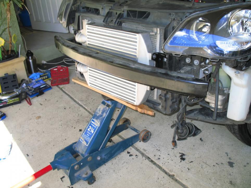

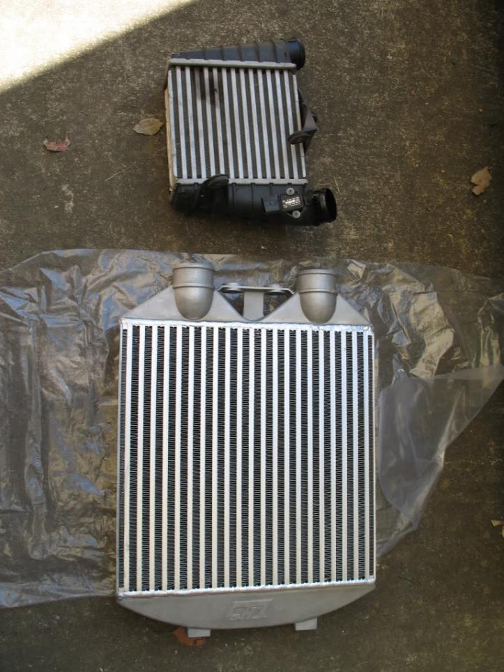

This is a picture of the intercooler size difference

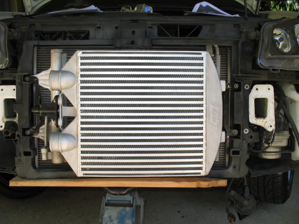

Intercooler bolted in

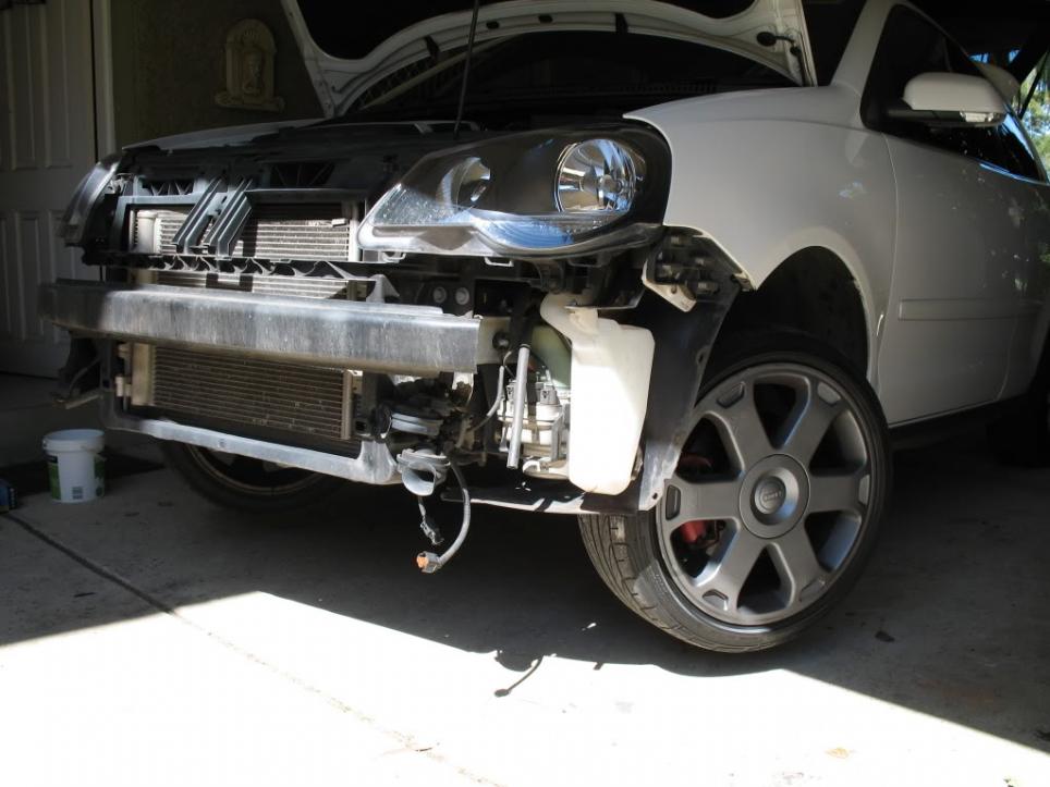

Car stripped down without the inercooler. Note the plastic in front of the radiator missing in the previous image.

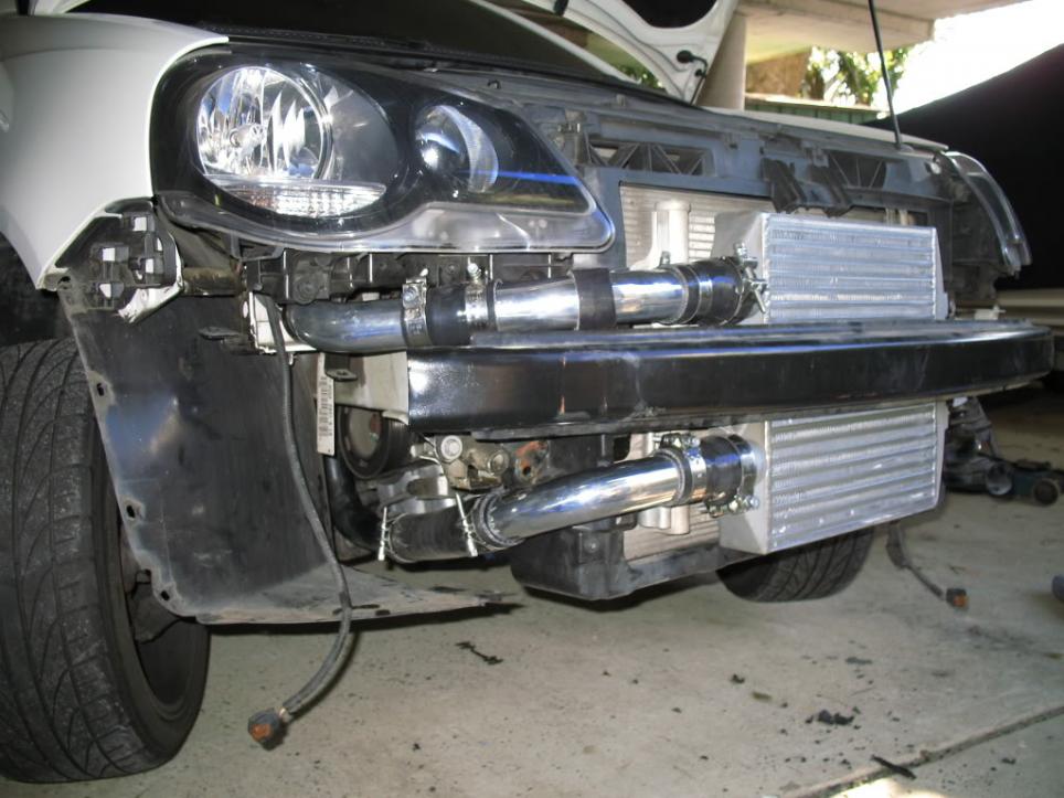

Crash bar installed
Pipework installed. Note thickness of core. Note the MIKALOR Stainless Super Heavy Duty Hose Clamps.
Super heavy duty. Definately recommend these.
