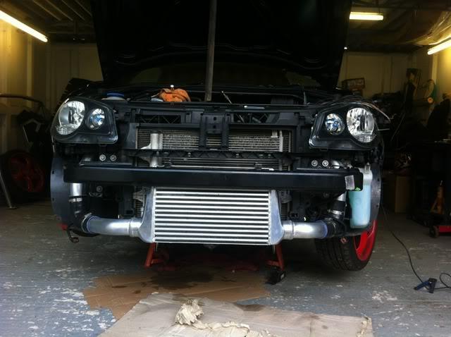

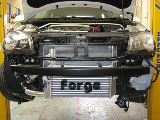

          My opinion had nothing to do with the thermal aspects of the coolers ..... its all around the flow and for me there is no way a cooler of the SEAT and Forge design will flow as well as the APR style one. For air to be performing a 180degree turn and to expect good flow characteristics just does not make sense to me.
          As far as I'm concerned a straight through design works best, followed by the APR style, followed by the SEAT/Forge design a distant last. Happy for a flow bench to prove me wrong .... just not seeing it until then.
            I don't understand what your trying to say to be honest, all the cores are a 180 degree design??? None are a straight through version.

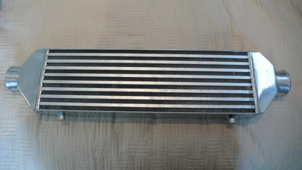

              Actually, no..... APR style (for the Polo and MK4 GTI) is a 90degree design ..... straight through not common on Polo's. I'd do 1, but it would require an intake manifold with the intake on the other end.
              Example of the classic and most efficient Air to Air IC straight through design ....

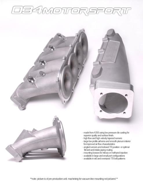

                    Sure can bud. Looks like it will be around $600 US when it gets released. Here is the teaser link
                    VWVortex.com - *** 034Motorsport - Transverse 1.8T Intake Manifold Teaser! ***
                    Massively increased flow
                    Or you can just do this
                    Yep it's a Polo!

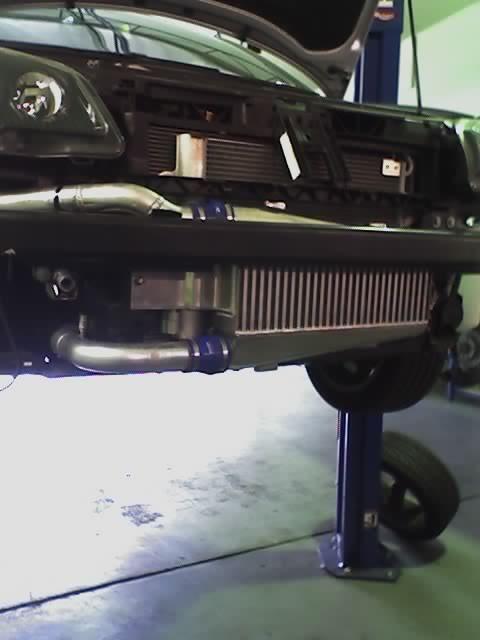

                              The air does not have to turn 180 degrees inside the endtank on sharkies unit.
                              It does a 90 degree bend. through the cooler then another 90 degree bend.
                              Would be interesting to compare the flow and whether the 180 degree design generates turbulence or restriction
