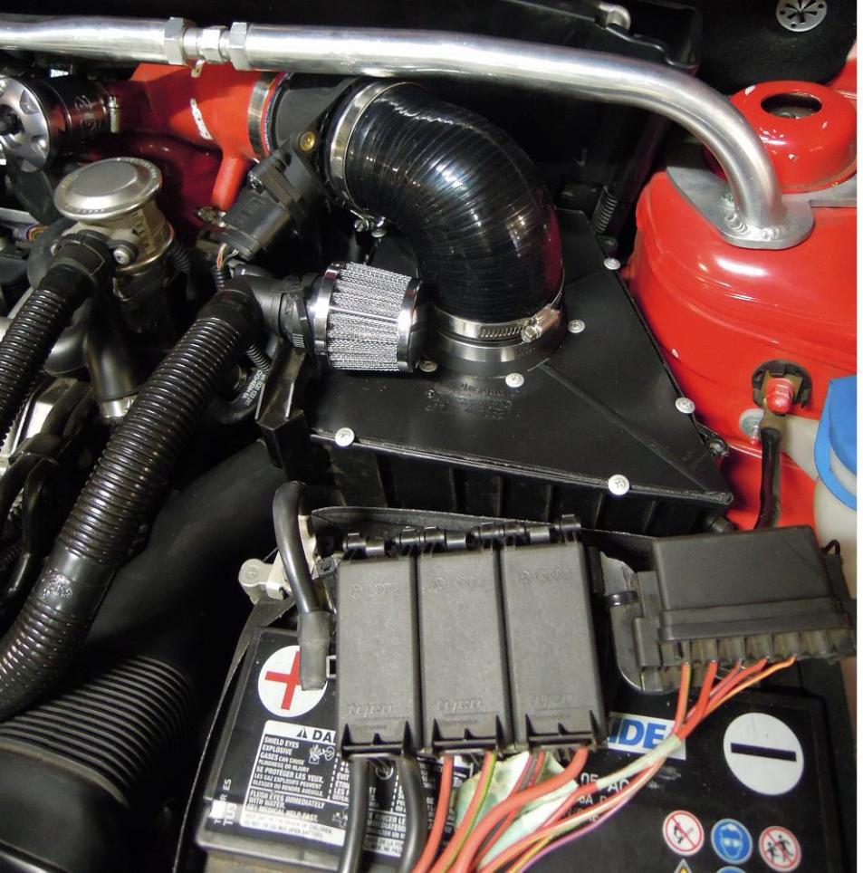

    I want to remove the top half of the airbox and use a pod filter in the bottom half, similar to the Jabbasport 'cone in a box' product, but minus the requirement to leave the top half connected.
    Its been done, a good version is seen in the Black Polo GTI 6 speed thread, for anyone who hasnt seen this thread, some great work in there, in many ways a street car on par with Plautos' track car.
    so my question is, once I fabricate the metal / plastic section to seal to the bottom half of the box, how will I keep it there but serviceable?
    I'm currently running a custom Jabbasport type setup with the 3A racing pod filter, want to take it that little bit further.

          Little update, pod in the box works well. Possibly slightly perkier, definitely more induction noise.

              Sure,
              90 degree silicone reducer elbow 3-2.5" onto Maf and short 60mm 3" pipe.
              Pipe goes into the Pod filter (the 3A one is pretty big but fits fine) which sits in the bottom half of thecairbox. Filter is secured to the new air box plate (mine is black plastic) with closed cell foam tape around the edge to form a seal with the air box. A few screws around the outside hold it into place.
              Photos later, mine looks the same as the thread linked above.

                  MAF to reducer elbow, elbow to ally pipe section (3"), Pod. Pod screwed to box to top plate to stop movement, plate bordered with foam and small screws used to hold it in place.
                  If you have not already guessed, I like to play with these sorts of things. Tried stock, oiled filter, pod in engine bay, custom airbox (not fully enclosed, but pretty insulated, same with heatshield, Pod in a box (using full airbox) and now this. So far, this is my pref. I cant see how I would need more airflow unless I did the full exhaust and I still think it would be sufficient.
                  Mini Pod on the SAI feed until I get that bypassed.
                  You might also notice I have removed the battery housing crap, a couple of cable ties holds the fuse / distribution junk in place just fine, much easier to work in that space without the plastic shell. Airbox can now be removed very easily.
                  If you are considering going down this path, making the elbow fit nicely takes a bit of time to cut it down so its not squashed or bending (reducing the internal airflow). A 3-2.75" reducer would probably be a slightly better fit, nothing wrong with the 2.5, just a little tight to get on.
