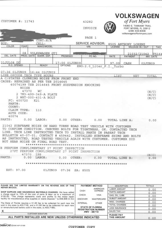

                  Well, I've left it for a bit as I didn't want to call it too early...
                  Tightening the subframe bolts has definitely improved the situation, even the missus said the car was unusually quiet.
                  So I'll be ordering the replacement bolts and lock tabs which are these for anyone interested:
                  Or these:
                  IN STOCK: DBC Tuning-Wholelsale Pricing On OEM VW/AUDI Parts
                  But... I don't think it's completely cured the problem. So I'll be getting the strut top bearings, LCA bushes and checking the hub bearings/bolts.

                    Ha, wow, those DBC bolts are $10, but $107 shipping.
                    I'd be definitely keen for a cheap place to buy a set of bolts and lock tabs, and any installation info if you've already found it. The clunking is driving me crazy.
                    • #25
                      Haha, I think if you emailed them postage would be more reasonable. I'm going to give VW parts a call and see if they can get them in with the part #'s listed. Here's a thread I found helpful in my searches:

                        They're $14US at ECS Tuning: http://www.ecstuning.com/News/MKV_Su...cer/ES2102460/
                        I will throw in 2 with my next order of things.
