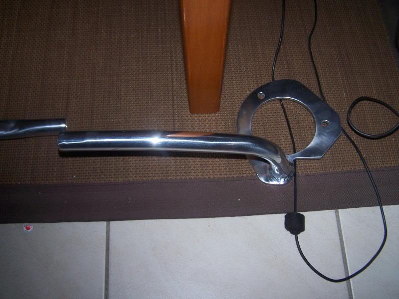

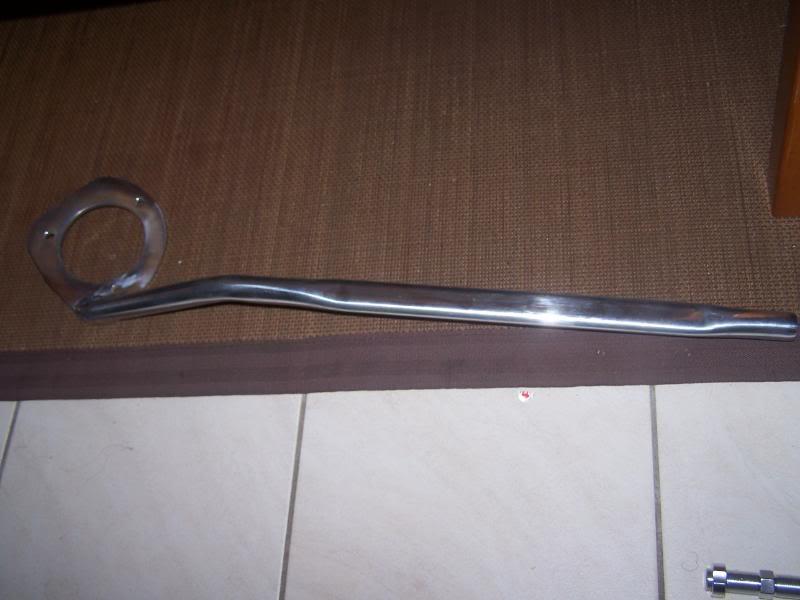

    Parts Needed - Strut Brace which includes
    Left hand Piece
    Right hand piece
    Tightening Bolt
    Tools Needed - 13mm Spanner/Socket
    19mm Spanner
    Time - 10 min

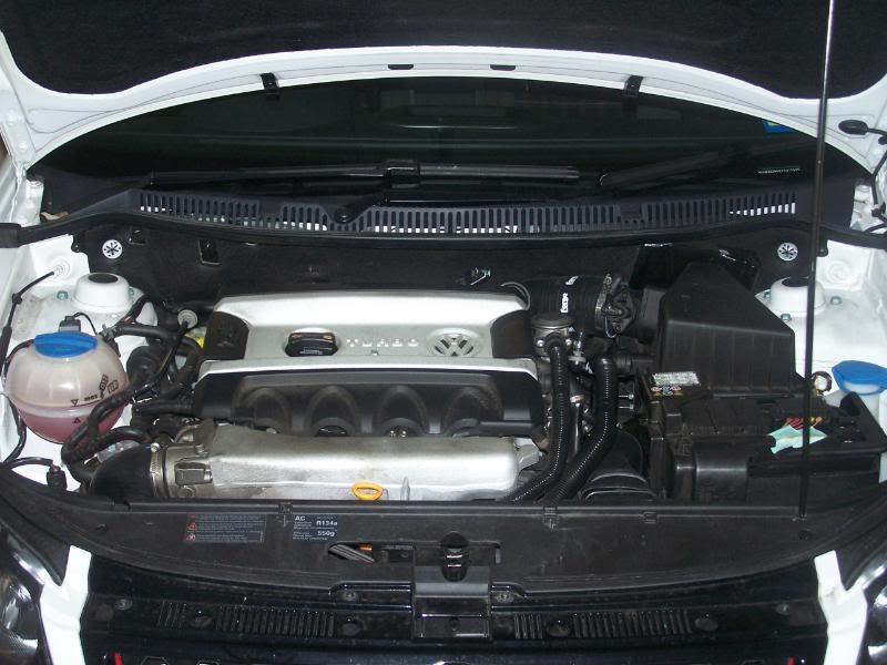

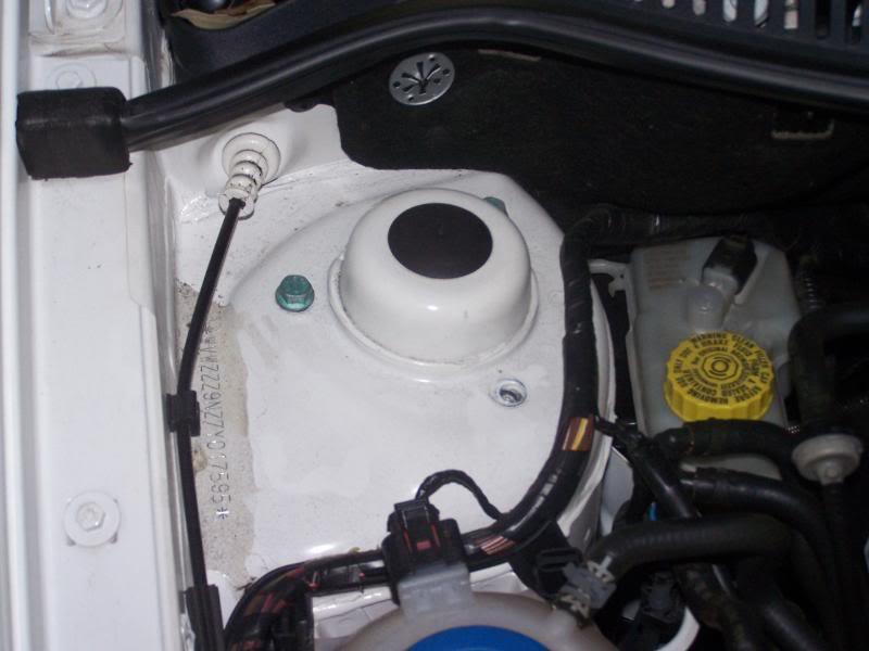

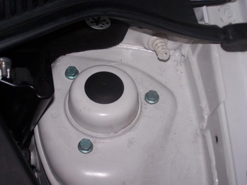

    Steps - 1.
    You have 3 bolts on each strut. Remove the three bolts with the 13mm Socket. Off one strut at a time and do the following.

      Step 2 -

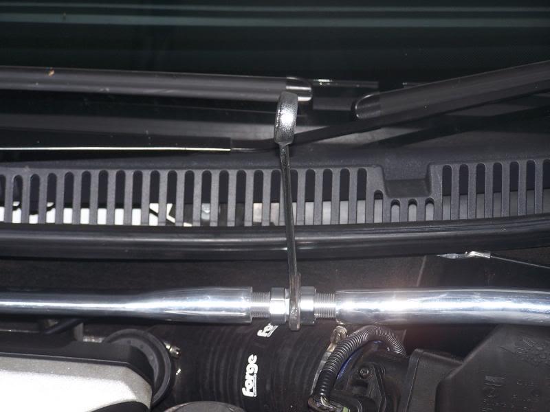

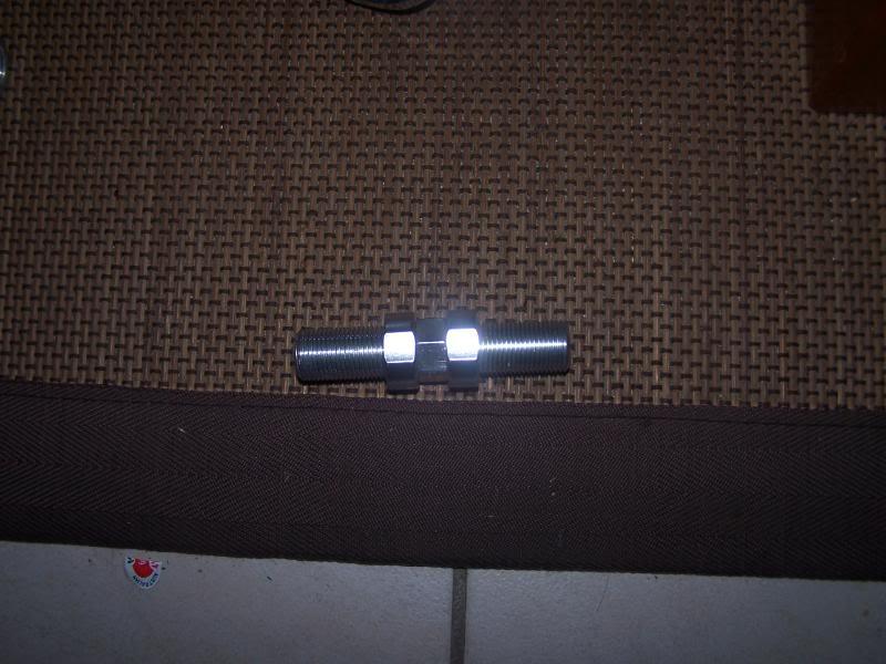

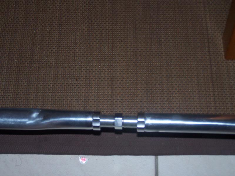

      Fit the brace on so that the bar is closest to you and the longer section is to the left. But before you do make sure that you have completely removed the Tightening bolt and threaded it back on the RH and LH bar evenly. (when you recieve yours the tightening bolt will be tight on the LH Bar) The tightening bolt is the 3 pic from the top which is used to make the strut brace tight.
      Step 3 -
      Tighten all Strut Bolts again.
      Step 4 -
      With the 19mm Spanner tighten the tightening bolt in the bar. when you have tightened it to your required amount (it is up to you how tight you do it, i did mine until it was firm) run the lock nuts up to the bar on both sides to make sure it doesnt loosen.

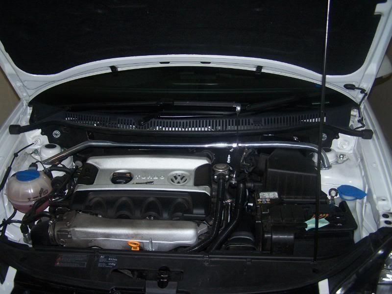

        Now your all done and should look something like this.
        I recommend going for a drive and checling to make sure all the strut bolts are tight and then again after 2 weeks or so.
