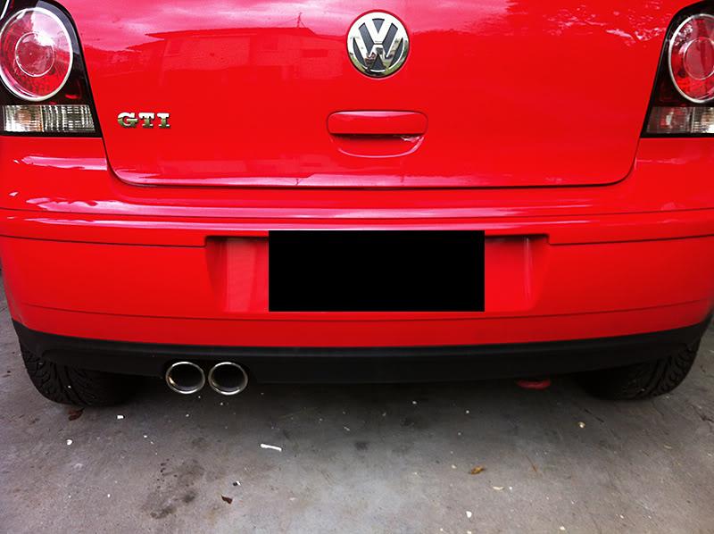

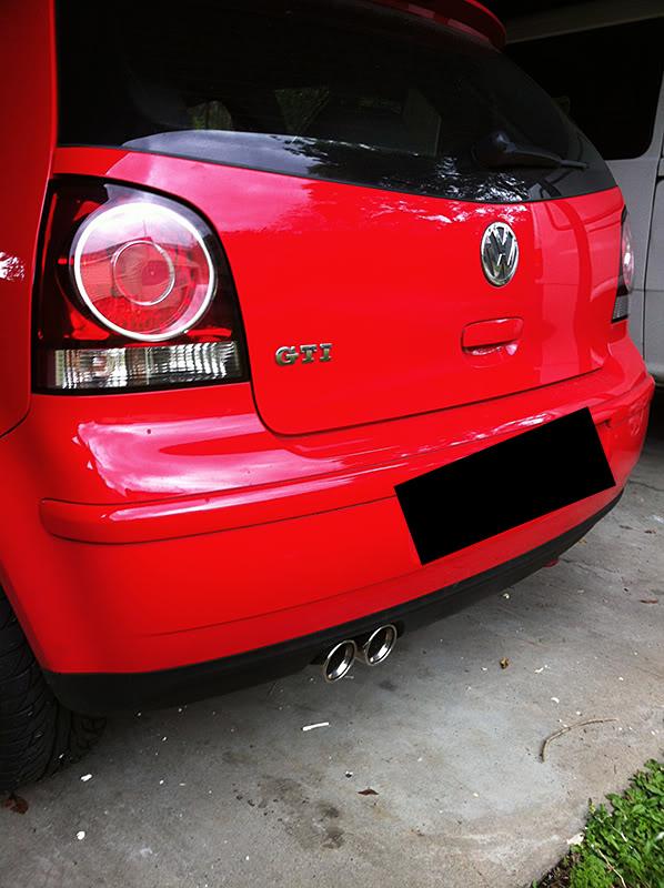

    Thought I'd post up a few pics of my Milltek exhaust.
    It's the full system from the turbo back.
    Fit was pretty typical of a 'bolt-on', needed a few tweaks here and there. Think I might pull the muffler down and out a little more when I get the time.
    Sounds pretty good, should burn itself in in the next week or so and have a nice note.
    There's also a substantial increase in performance and not just a placebo effect from the louder noise.
    The biggest thing I've noticed is the sound of the turbo spooling!

    Glad you are enjoying it.
    The turbo back systems do give a performance boost over the cat-back systems.
    How much did it set you back?
    Hope we can hear the thing at lakeside happy laps in December?
      Yeah it's pretty obvious looking at the stock dump pipe that that's where the restriction is. The rest of the stock exhaust system looks pretty good. Landed at my door it was $1600. Couldn't recommend the service at Rennenhaus more

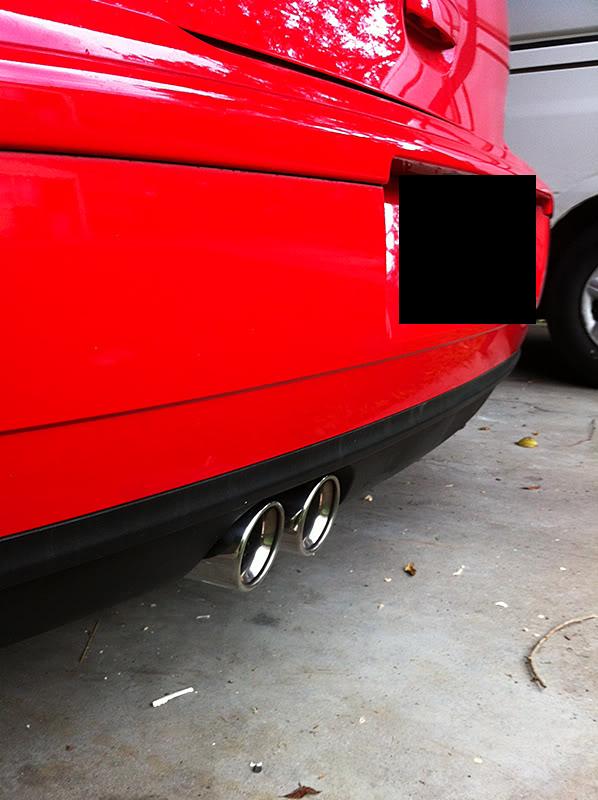

                Is the muffler the same fitment as stock one, I like the look of the standard twin pipes.
                  They're pretty much identical, just bigger and better I love the dual tips
                  I've dropped the muffler down a bit now so it sits in the same position as the stocker.

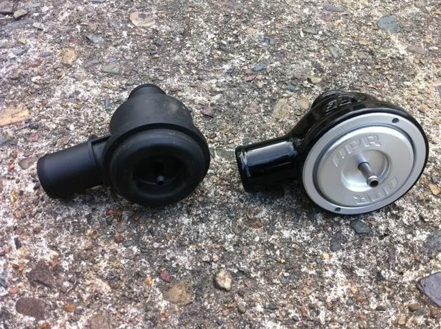

                          On another note, fitted up an APR R1 diverter and it feels like I've unleashed the beast!
                          I had Guy check the stock diverter for me when I had it chipped but it must have started leaking since.
                          To all those chipped and still running the stock diverter, seriously consider upgrading. I thought my diverter was fine but it feels like I've added another 20-30hp by the seat-of-the-pants now

                            Good luck with that one.
                            It made my car shake since it transmitted the engine vibrations through the rest of the body.
                            I ended up going back to stock.
                            Might be better for the polo though.
