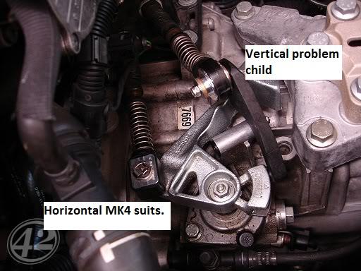

PM replied. Below outlines the problem side in the 08-09's. This is off a USA Rabbit and I believe the Polo is a steel arm, but it's basically the vertical mech bush that is the problem....
Just so it makes sense to both the guinea pigs, and to you guys when you go to fit, the square end links take round bushes. Yep it gets confusing, but all the end links are either square or rectangular. The later model rectangular ones take a rectangular bush. There are no square bushes. Please see the first MK4 fitment on the above link, and the second graphic showing square links and round bushes. My TDI has one square bush, which took round bushes, and I can confirm they are a perfect fit!

3. Enlarging one of the holes on one of the 42DD bushes. Would have taken seconds if I had the right tools. The other 3 fit perfectly

Greg, I've got pics at home with which bush was used for the vertical link. I will email these to you tonight.

Sounds like you need to slightly adjust the vertical mech cable length, and I'll have a video on doing that up in the next day or so. Basically making the cable end longer, moves the gearstick away from you, and making it shorter moves the stick to the left. I found just one notch on the cable end shaft made all the difference with notchiness. It's like the rubber OEM bushes have enough slop to allow the gears to "deflect" into place if the alignment isn't quite right, whereas having them tight you need to fine tune the H pattern alignment. BEFORE anyone tries that, mark the steel shaft with a nikko pen so you know where you started from, as just one "tooth" makes a big difference, and the stock setting is always perfect / close to!
Once I find out which bushes you Polo guys need, I'll most likely need to get a special order in, as it sounds like the 2008-2009 Polo kit will be a frankenstein mix of a few bushes from 42DD, and I only have about 4 kits of each model in stock at any point in time. Once Tommy lets me know the hole enlargement, I might be able to get a specific drill etc to prefab them before sending.
Anyone with a 2007 or earlier with the HWY gearbox can just run the MK4 kit, you have it easy, and I have more of them landing next week.
Here's the two steps I think you have left to do Tommy, the rebuild of the cable end shaft, and the pivot itself, but I understand if you'd prefer not to go cutting things!
