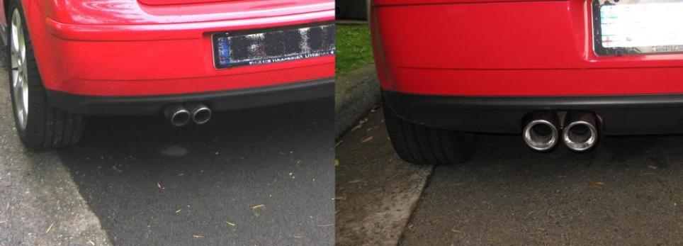

    Here they are;
    Before / after
    It is noticeable by contrast, but your normal Joe would not pick it. Add the debadged back and blacked VW badge and the back is subtly nicer.

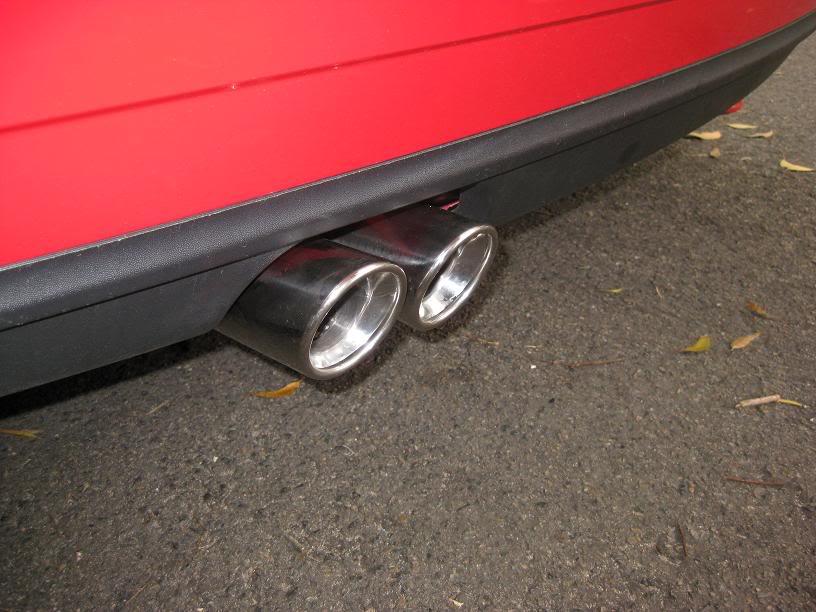

          The new exhaust tips really complement your Polo GTI. Where did they come from - and how much ($) ?
          • #20
            Bought from an exhaust shop, cost me about $200 for tips and fitting. Normally I'm more frugal, but the tips were what I was looking for.
