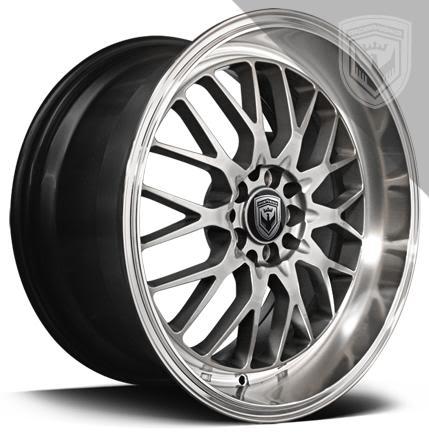

                            Found these offset 33. i really like them and reasonable price too. Not too sure about quality though....
                            2006 Polo GTi Black | Leather, Nav, Cruise Control, Parking assist,BMC CDA, Phillips Diamond Vision, Black/Red emblem, Custom remap 199bhp, 35mm H&R
