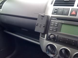

    This is what i need to remove. Ive tried wedging with a steel rule screwdriver the lot. Do i need to remove the Stereo headunit to gain access?
    Thanks Guy

    Yeah. I think pulling the stereo out will be the better option.
      Need to go buy a set of them pins to remove it tonight see if i can get a look in.
      2006 Polo GTi Black | Leather, Nav, Cruise Control, Parking assist,BMC CDA, Phillips Diamond Vision, Black/Red emblem, Custom remap 199bhp, 35mm H&R
        Remove the stereo doesn't help any! don't west your time and get those pins!
        There are some screws holding the phone holder, you need to remove the front screws then, you can get access to remove the two hexagon socket head panel bolts at the back.

            Ahhhhh Yees, great thanks boys.
