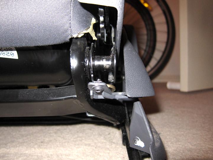

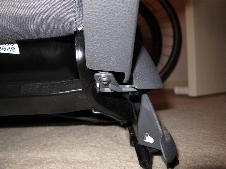

      • Here's the fix for the seat pull issue.
        The area you will need to investigate is pictured in the first picture below.
        This is the right rear corner of the driver side seat. For passenger side seats, it would be the left rear corner.
        In my case, I found the coin had settled in the area where the torx screw is.
        As you can see from the first photo, it would be impossible to spot the obstruction if you didn't know what you were looking for.
        Anyway, if you look at the second photo, it becomes slightly clearer. Loose change can trickle down into the inner workings of the seat and obstruct the path of the hook that allows the seat to move.
        You should be able to get a better view of the possible obstruction by undoing the torx screw and gently bending the plastic bit held in by the torx.
        Fixed seat, and $2 profit.
