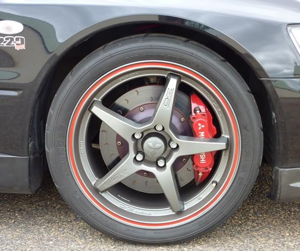

    Even bigger brakes may not help if your old man is not using the car properly. Dont know how much track experience your old man has but its common for beginners to ride the brakes. You have to either brake or gas (or just coast if your still learning), but you cant ride the barkes or they will over heat.
    I know someone with an Evo with a huge brake setup (see photo, and yes they are 18 inch rims with 6 pot calipers and 2 piece 343mm rotors) he had the same problem at Wakefield. He changed his driving style and problem is now gone. Unfortunately by then he already needed to have his rotors machined twice from heat warping.
