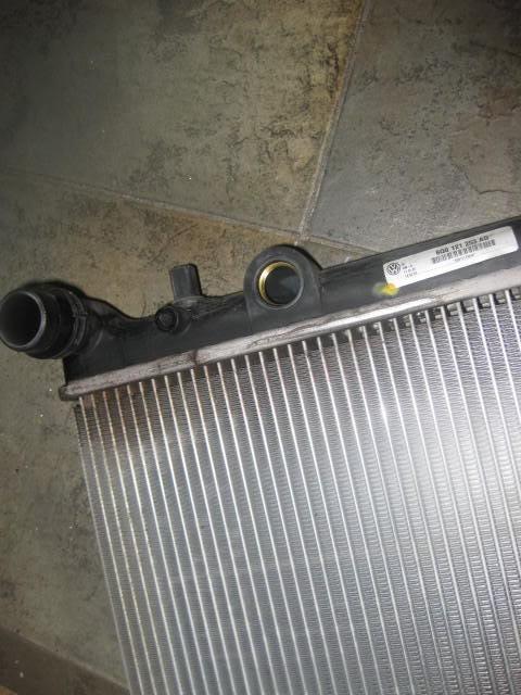

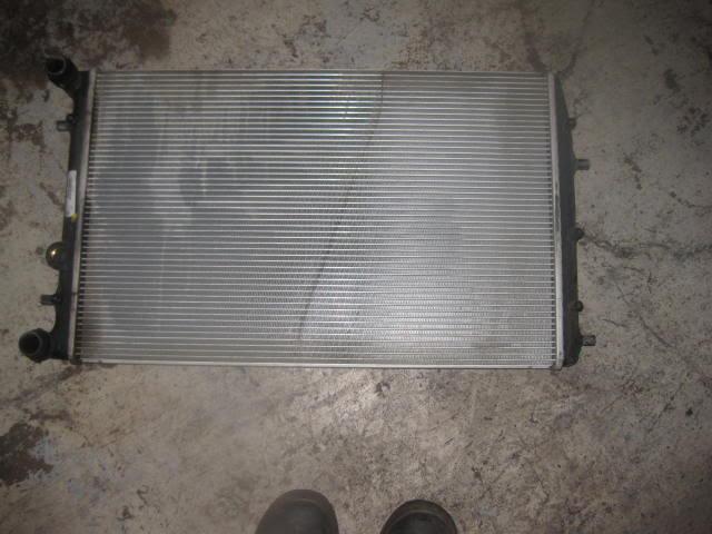

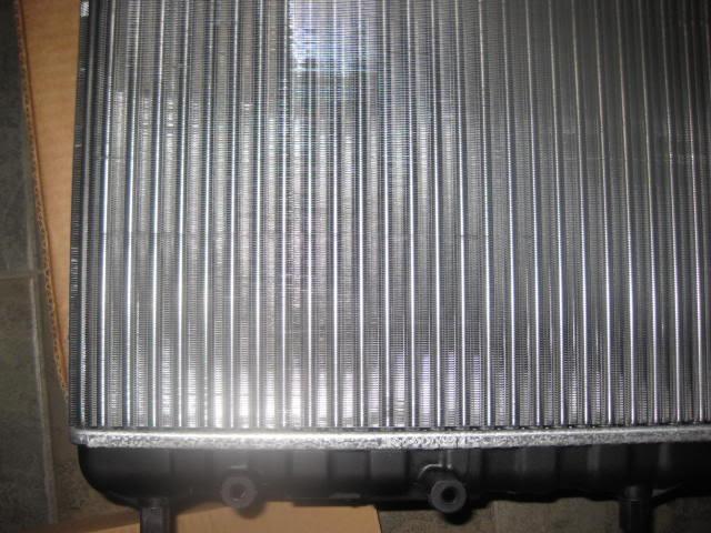

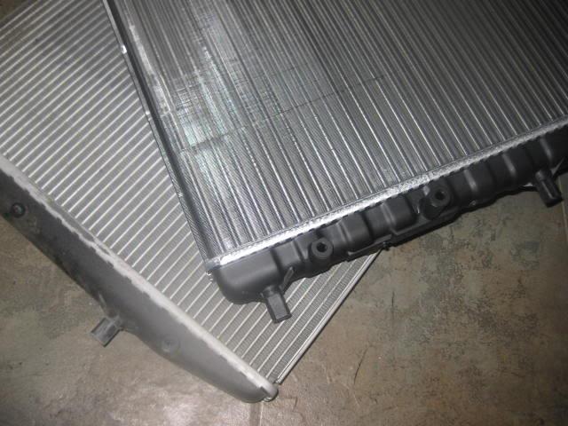

          After receiving the first batch of new updated radiators not long ago the first unit was installed today. Its very similar in design but the fins are a lot thinner and the crimping where the old radiators leak has been upgraded:
          The old radiator:
          The area of the leak:
          The new radiator:
          Old and new radiator overlapped:
