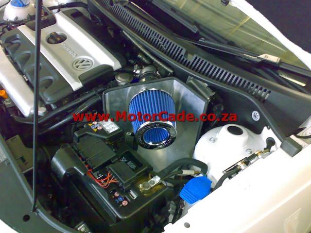

                          I made a further change to my air intake..
                          I fitted my pod filter straight off the maf sensor (I also have fitting bolted up to MAf sensor).
                          I went to bunnings and bought a sheet of aluminium for $12. A bit of cutting and bending and hey preto a heat shield. I have the Pod filter on top of the stock airbox with the lid removed entirely. But the heat shield as a circle cut out for the Maf to slip through and the heat shield extend upwards to the height of the bonnet (when closed). It also bends around to go through the gap between the battery and airbox. (to make it higher)
                          Is it better than Panel filter/seat combo??? I think so as its a shorter route for the air to turbo, the pod would make it less restrictive and Ive shut out all the hot air under hood..
                          If anyone wants photos I can post.. Its a cheap mod, grab a pod filter and a sheet of aluminium and your done.

                            Very similar to this but mine wraps around to block between the battery as well.

                                Not bad for under $12.
                                Pics below..
