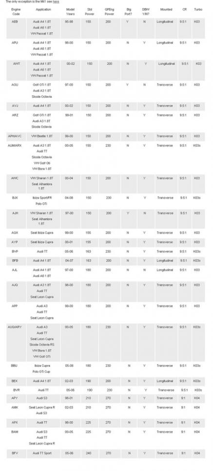

                              Ive had this discussion on this forum before, the PGTi(mine) does have a K03s, im not sure if its only in South Africa our Polo turbos kept breaking possibly due to the altitude in JHB. My tuners confirmed I have a K03s hence my massive gains on a phase 1 map.
                              Heres a link confirming turbos on VAG cars.
                              The K03s has a larger diameter inlet and outlet.
                              thread
