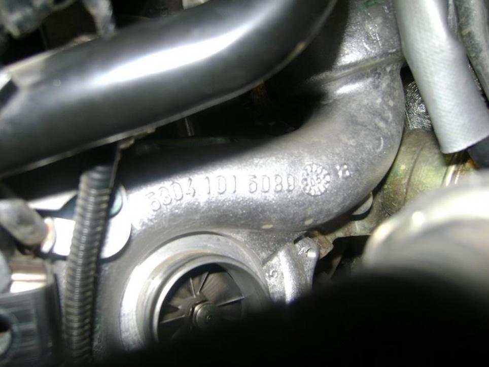

    Can anyone confirm 100% whether the Polo GTI has a KO3 or KO3S turbo? I've come across information that says the Polo Cup GTI has the same engine as the Audi TT 180HP (fitted with KO3S turbo), but the Polo GTI has the 150HP engine/normal K03. Can we confirm the Borg Warner product codes and work out which is which?

      what is the serial code on the sticker in your other photo?

          putting that 5304 101 5089 code into google though brings up many results indicating it is the KO3S....i'm confused??

            I've tried Bog Warner's site and it doesn't display anything for 5304 101 5089. What we need is the OEM part number - that might do it.

                we all thought that, but may not be the case. as soon as quest confirms the OEM sticker number, we'll know.

                      Originally posted by Quest View Post
                      Here is what you want :
                      Thanks Quest - bit hard to read what the final numbers are

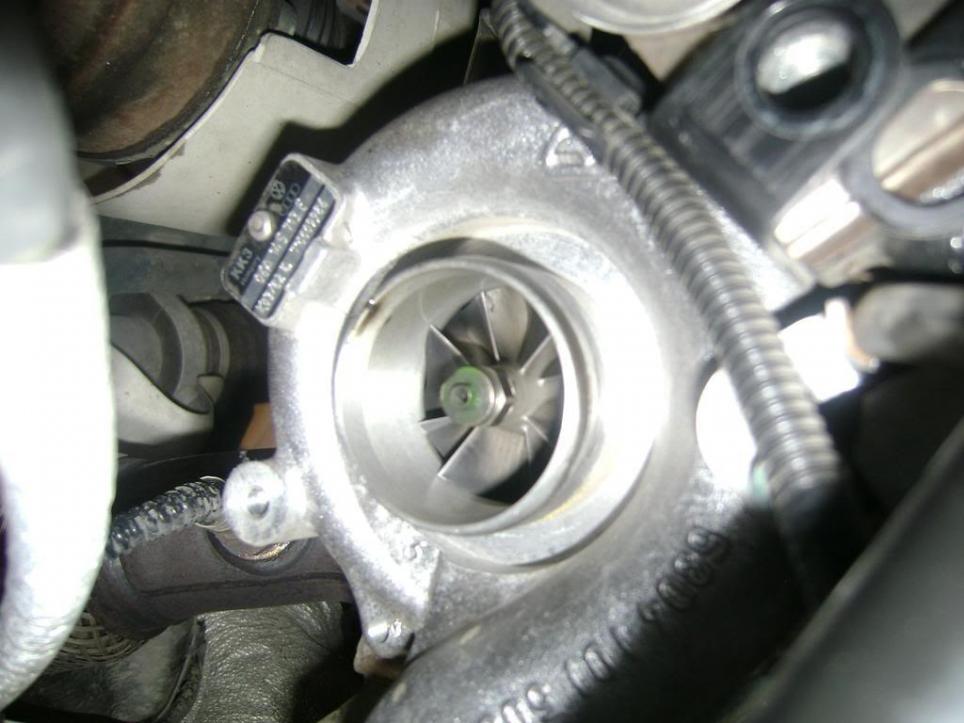

                        Hey guys,
                        I've updated pics above but here is what i can read when i do an extra zoom on it :
                        5304 101 5089
                        06A 145 713 E
                        K03/82C 710009986
                        Neil - Hope it will help...
                        Cheers,
                        Quest
                            Hey guys,
                            5304 101 5089
                            06A 145 713 E
                            K03/82C 710009986
                            Cheers,
                            Quest
                            I think you will find that is K03/52 (note there is no loop on the upper right side which would indicate a 5 over an 8 ) which acording to your list Neil is a 180hp turbo.... I suppose you could classify this as a K03S Also note that 8 blades are present on the pictures posted by Quest which would further indicate a K03S
                            The enhanced efficency also mentioned in your list would go a long way to explaining why a flashed Polo GTI will make more power than a flashed IV Golf GTI... the tune is the same it's just that the turbo deisgn is slightly more efficent

                              I'm not sure...have a look to Blitzen's one
                              It's a 8 like me !
                              It's rather the 82C that i'm not sure. Maybe it's IC or IG ??
