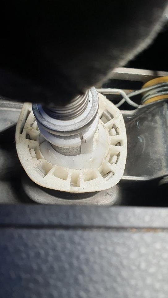

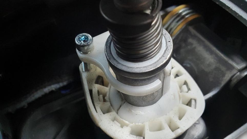

          Excellent advice. Thank you so much. I went through the entire process suggested and 3rd-5th gears work much better. But not without some complexity.
          Unfortunately the plastic inside the gearstick assembly has cracked and worn away. The locking holes were completely misaligned because the collar is cracked, that when you lock the gearstick, it still can be moved significantly.
          I'll have to replace all the plastic to get first and second down pat. If you push too far to the left, you sit juuuuust inside the reverse gate and cannot shift to first or second, but most importantly, you can't shift into reverse by accident.
          I'm about to Google the **** out of this. Anywhere I should start?

            Replace it with a 1.9tdi one, exactly the same lengths and all. Difference being, it's all metal so you'll never run into any problems like this again. I think the throw was a tiny bit longer and also the stick sat a little higher. that's really about it
            Had similar issue with mine, where the cable sheath had split at the gearbox end and could not be crimped back together, so couldn't pull out of gears.
            Swapped it out, took about 2 hours with a mate. only trouble is exhaust is in the way, I had mine flanged so I can drop it out the car whenever without dropping the rear subframe.
            Happy fixing
              Yep or get one out of an 06' Polo gti, they had the metal shifter gear too - well mine did at least. But the fact that the movement through the gates improved after the setup does suggest its the shifter unable to act on the cable lengths accurately. Get onto it before something gets damaged or you get stranded. and yeah as above unfortunately its a pain of a job as everything needs to be dropped away from the floor pan before it can be swapped. I reversed mine up car ramps and then jacked the front as high as possible which helps get it all well elevated. good luck! but look on the bright side, the box itself is probably ok.
