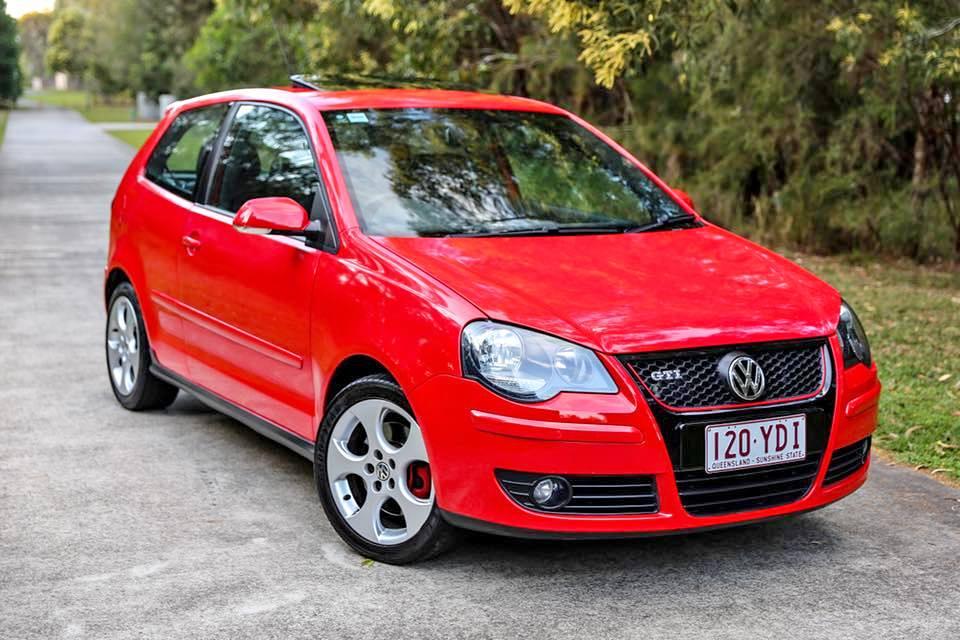

    My little 2007 Polo is standard.....at the moment. It is essentially going to be used for driving myself from home to the bus station each day (and back) and from home to the gym as well as frequent trips just for fun throughout the week or meets when I get involved (we do bigger trips during the weekend in my wife's car).
    Pretty sure that my next investment will be in the rolling variety (I like large wheels), so am thinking a set of 18"s won't go astray
    This will probably be followed by a rear sway bar (I've read some great stuff on here about this being a must)
    Exhaust/Intake improvements
    Stereo
    After that...who knows.

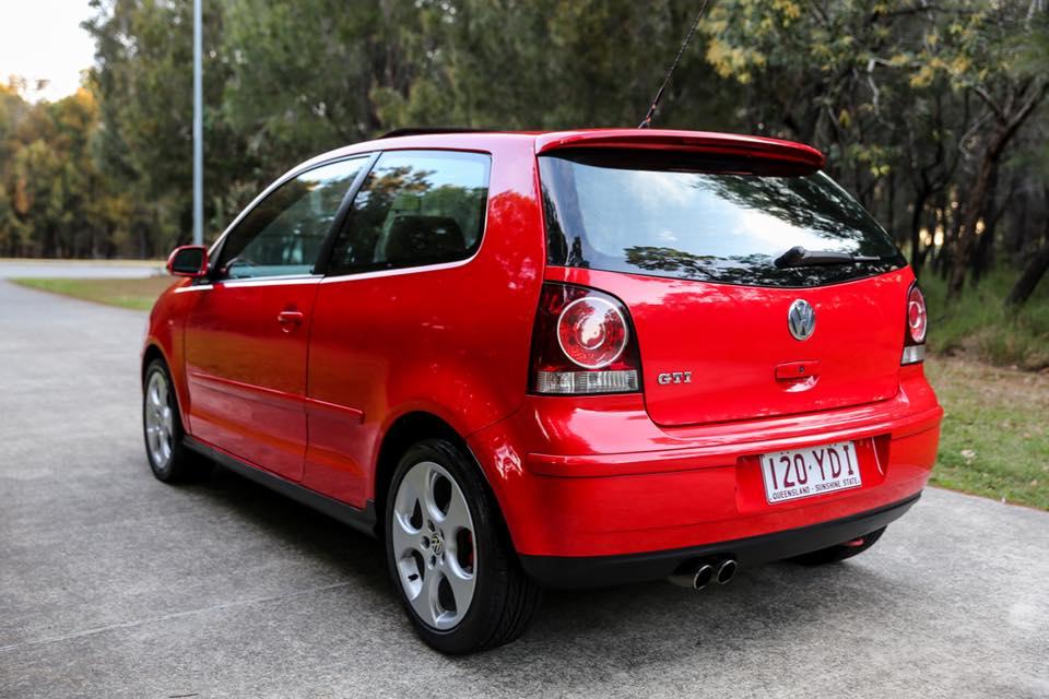

        looking at the first photo, it's really crying out for some rear wheel spacers. I should take a photo of my car at the same angle, it looks phat
          I literally bought it on Monday. Took those photos from the seller. It looks mint IMO, I'll need to look into cleaning tips methinks.
          Hmmmmmm rear spacers you say. I'll look into that, depending what wheels end up moving it around
