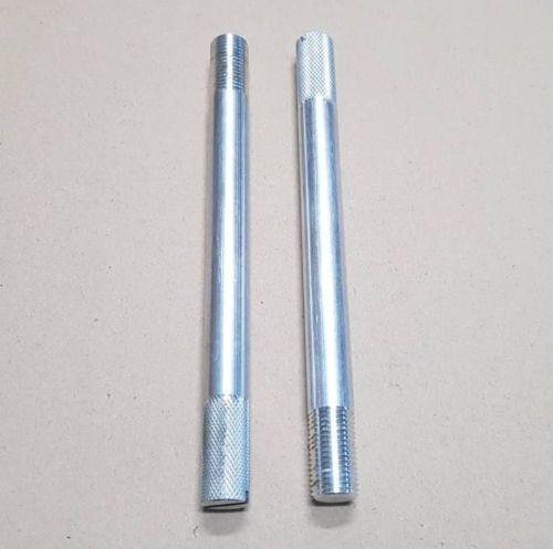

Originally posted by simon k View Postthe other thing you can do at the track is get a bit of 14x1.5 allthread, cut a couple of 6" lengths and use them as a temporary locator while you get a couple of bolts in, then take them out and put the rest of your bolts in. Not as practical as studs, but does save some cocking around.
EDIT: or grab a couple of bolts and cut the heads off... 14x1.5 allthread seems a bit of a rarity according to google).
2pc Aluminium Wheel Hanger M14x1.5 Lug Guide Tool VW Golf GTi 1999-Onward | eBay
Cheers
GaryGolf Mk7.5 R, Volvo S60 Polestar, Skyline R32GTST
Metal Mate RCR 12 x 1mm 1m Aluminium Round Tube | Bunnings Warehouse
This lets me jam the tube into one of the holes in the wheel (the heatshrink holds it in place) and then easily get the other end of the tube into one of the holes in the hub which then guides me getting the wheel on. The aluminium is strong enough to hold the wheel in place, too, while you scrabble around for the bolts, especially if you put the tube into one of the uppermost holes.
It also helps hold the wheel on until you are ready to take it off when you are removing the bolts (rather than having it fall off at an inopportune time).
Best of all, you don't have to screw the tube in and out (plus it costs bugger all).
I'm happy to give one to anyone in Melbourne.Last edited by kaanage; 14-08-2018, 01:02 PM.Resident grumpy old fart
