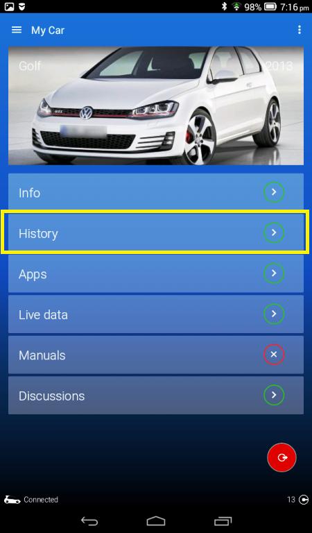

        Kris: Hopefully you didn't use an App because the history records for Apps is normally fairly perfunctory. Sounds like you were manually playing-around in the modules - which in many ways is better because the History records are more complete.
        Of course the inadvertent changes may be in any module, so you are probably better getting into the History records from the My Car point (rather than via a specific module) because this gets you records across all modules
        Something like my screenshot below might help, then carefully look though the records. My hunch (and it's just a guess) is that you probably messed-up in the Gateway module @ address hex19. I'm guessing this because the "multi-function" module that controls the steering wheel switches is a slave module to the Gateway module.
        Good luck
