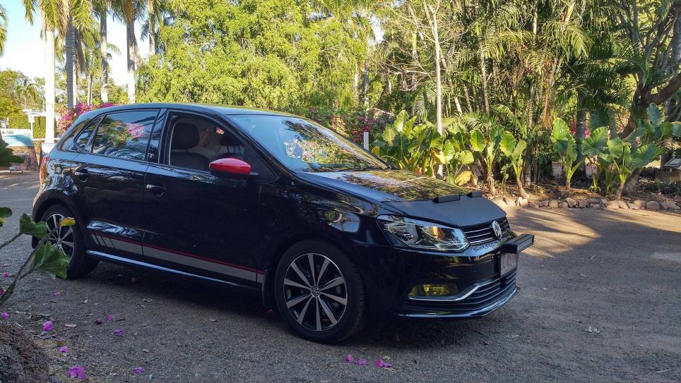

    So the finished product looks like this:
