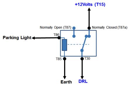

    So - as I say, I don't have a wiring diagram for a Polo 6C), so what I'm saying above is a quess. But if I'm correct, then you have two options (IMO): First - you could run two new wires to the BCM pins and then program the Leuchte-sets for DRL operation.
    Second- you could operate the DRL from a new relay (which you will need to install). This relay would be wired so that the normally-closed contact supplies the DRL when the headlights aren't energised. Note: the 12Volts to the relay contact needs to be a "Terminal 15" supply - which means that it must only be live when the ignition is switched-on. You should be able to find a siutable T15 supply on the fusebox - since the LEDs won't draw too much electrical current, the additional load shouldn't be a problem for the fuse size.
    To get the proper operation, the trigger wire to the new relay will need to be connected to either the Parking light, or the low-beam light.
    See the diagram below
    Don
