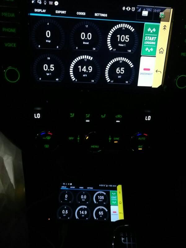

        If you have android phone, you might be able to mirrorlink the gauges to the main screen.
        You enable video in motion, then it will display while you drive.
        I've set it up for my jb4.

            The 2010 Polo I'm getting doesn't have the new headunits with mirror link etc. But the display you have under the HVAC system is exactly where I plan to put my tablet/phone if I use torque pro. How big a phone/tablet can you fit in that compartment? I have an 8" tablet that I assume is a no go though.. I have a few spare old phones I can use.
              Sorry mate, was meant to measure the gap, but I guess you have the car now.
              Enjoy!
