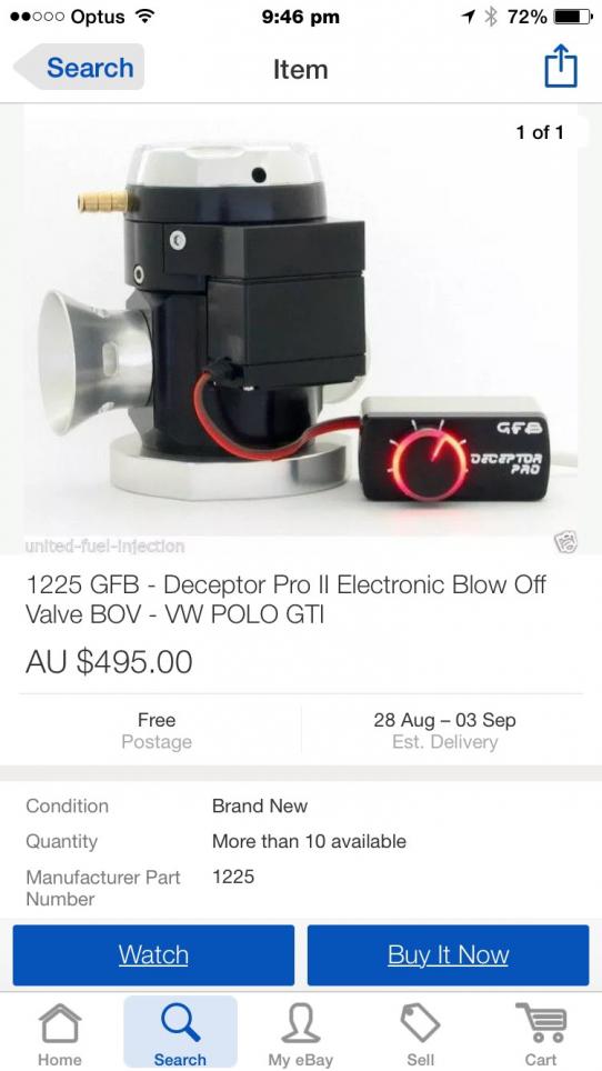

    too bad its around $500, would've been interested if it wasn't a ridiculous price right now.
    Blow Off Valve and Kit for Audi and VW 1.8 and 2.0 TSI
    Does anyone know if this blow off valve is suitable
    Would love the adjustable option
      Blow off valves are not a good idea on these cars that have a diverter valve, there are many many threads about them and why they adversely affect performance etc.
      If you're after the "pssstch" noise then maybe a supra or 200sx would have been a better choice... in all seriousness though, for the sake of a sound that leaves most people shaking their heads at you as you drive past, would you really spend $500 to make the performance of your car WORSE and more unreliable....?
        My MY16 GTI already has a muted psshhht sound as it diverts the boost as stock. More than loud enough in my opinion
          Thanks for the info guys will wait and see how the car goes when it arrives then go from there I thought $500 was a bit rich I might call the company that produce them and ask about the valves
