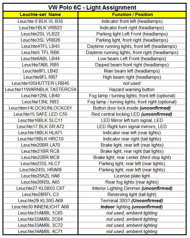

    Anyhow the real reason for this post is to share some fundamental information that I hope will be useful to those here who want to alter the way that the external lights in the Polo 6C operate. I'm referring to "Leuchte programming" and to the emerging expertise that is now growing on a number of forums as members become more familiar with the different possibilities for altering lamp behaviour on MQB platform vehicles. Whilst at the current time, many of the control modules in the Polo 6C do not yet have label files (so it's not possible to meaningfully attribute Bytes and Bits to the car's functions), data relating to adaptation channels is readily available
    Polo 6C owners can create adaptation maps of the control modules and the few admaps that I have seen for this vehicle confirm that the Leuchte channels are very similar to those in the Golf Mk7, Audi A3 8V and Seat Leon 5F. This means that it should be possible to translate Leuchte programming tweaks from these other vehicles (which are now more mature) and apply them to the Polo 6C.
    The difference of course is the Leuchte channel designations which are unique to each model. So, to kick-off any possible interest in this topic, I enclose below a list of the Leuchte channel designations for the Polo 6C. I have sourced this material from a German forum (thanks TBAx), and the information has been translated using the Google application.
