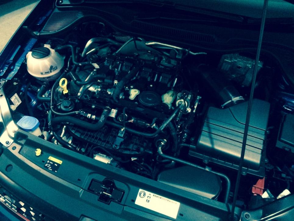

                    I'm with Car_Nut on this one. My baby just consumed 6L of Castrol's finest 5W30 504/507. This included a filter change.
                    1) Knowing Umai Naa!! is/was a VW tech, I safely poured in 4.5L (as above) and it just started to show at the very bottom of the dipstick. Ran the engine for a short time then shut it off. No oil showing on dipstick after 60secs.
                    2) Poured in remaining 0.5L of the big bottle. The oil level then was still below the required 'cross hatch' section on the dipstick.
                    3) Ran engine, shut off after 1min. Oil level remained the same, as per above.
                    4) Grabbed the matched 1L bottle of oil, poured half in. Oil level halfway up suitable dipstick level.
                    5) Poured remaining 500ml in. Perfect result. Dipstick showing level about 1-2mm short of the top of cross hatched section of the dipstick. As per VW, that is "spot on" as read in the manual.

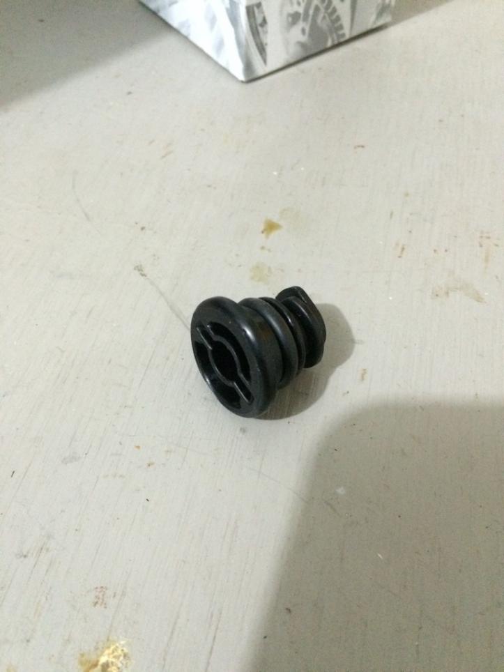

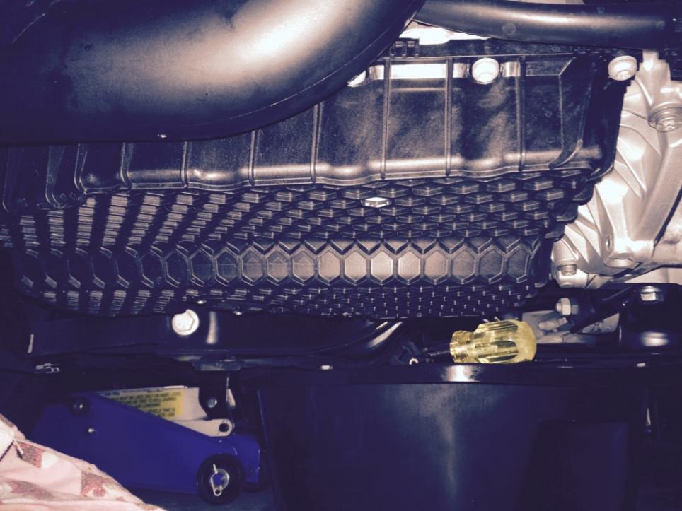

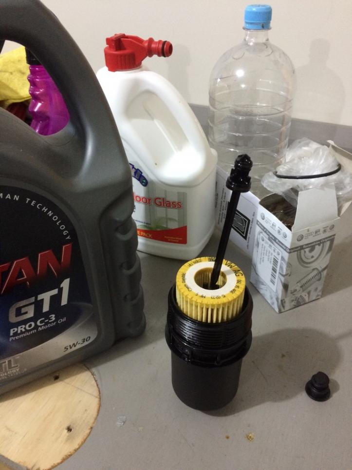

                    Very different setup to my old Mk6 GTI;
                    * Pain in the arse plastic shield needs to be removed to access sump plug
                    * Plastic sump
                    * Plastic sump plug
                    * Plastic oil filter housing with cartridge filter now
                    Not a bad way to spend a Friday night!
                    And yes, more that 6L was sitting in the oil pan after draining. The factory has FAR more oil put in than required in their engines.
