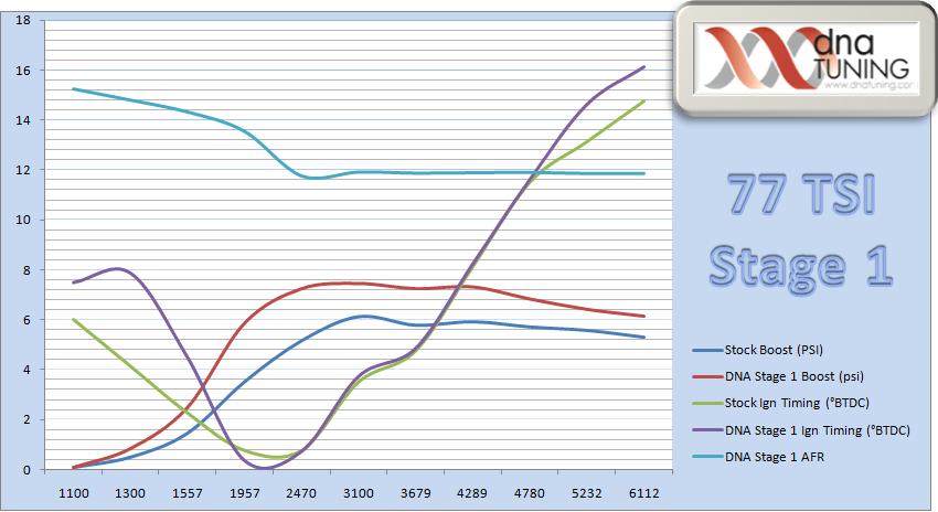

            ^ are you sure they run 14+ PSI stock? I thought it was 5-6PSI as thats what DNA Tuning quote on their dyno/power graphs for the 77TSI.
              I thought so as well but my boost gauge doesn't lie
                the 1.2 TSI is running on 1 bar boost at stock.

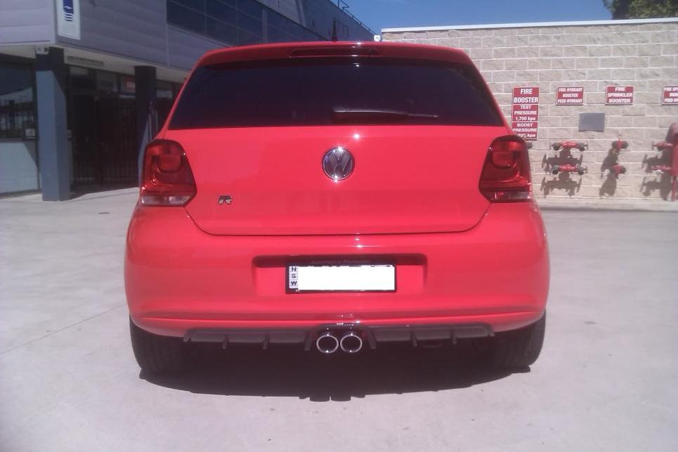

                        In my humble opinion, If I were you I'd think about spending some coin for this mod:
                        Had it done after owning my 1.2 for a month and enjoyed it for 3 years before selling her, subtle increase to sound, legal, great DSG fart
                        Talk to ABT Sportline Australia if you're keen to bite
