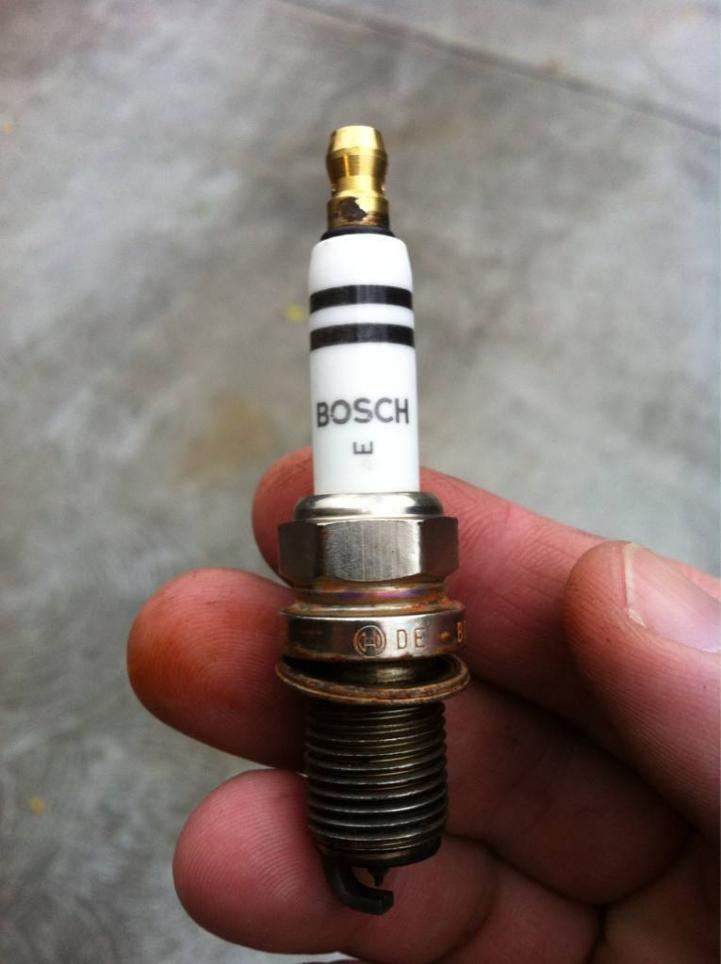

    Anyway here is a picture of one i removed... Does it look normal for a 20000k old spark plug?

    More or less. Possibly a bit hot?
    It's a platinum or iridium so it only needs changing every 60,000-90,000 (depends on the plug)

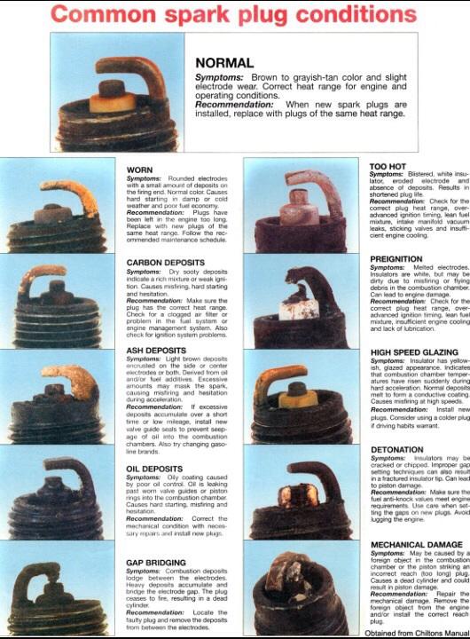

      Looks like it's been running a bit hot to me. See chart attached. Caused by lean fuel mixture (which leads to hotter temperatures in the combustion chambers. Petrol has a cooling effect, so a engine that runs richer will run cooler).
      You might want to try a cooler spark plug.

        What brand of plugs are they if you don't mind me asking? NGK / Champion / Bosch?
        They don't look very heathy but I would have thought with the tune it would be running more rich. Could also be oil fowling considering the amount of oil these engines drink
          They're NGK Iridium IX... I decided to change them as the engine was idling rough and occasionally misfiring when cold... Also very wet soot at the exhaust... Should the plug have oil all over it?
          The plugs were gapped to 0.8mm... (apparently)

            Ahh ok yeah the NGK iridium IX are awesome spark plugs, really good performance. I wanted to get some for my 1.2tsi but they don't make them for it so I had to get the OEM laser iridium.
            And it's allways an idea to check the gap size becuase sometimes they can get squashed in transport.
              Lean fuel delivery. Common trait with the factory engine mapping but I know yours is running the apr tune so maybe speak with the guys at apr and shoot them the pics.
                Not saying this pertains to the polo but Some engines don't like iridium's. Iv had a thew bikes/cars that would not work no matter what the gap/heat range of the iridium plugs are. My aprilia would only run properly on stock plugs before and after it was rebuilt for racing and tuned.
                I would put some clean stock ones back in for a bit and see if you get the same result.
