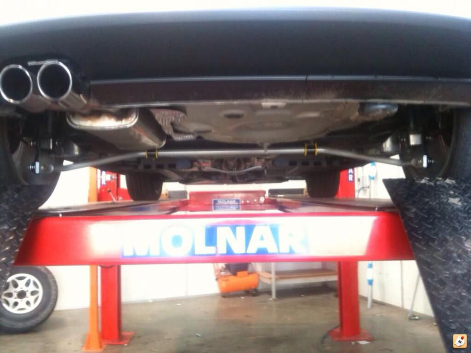

    Through a contact a plan was setup to see what anti roll bar woul suit the bum of the new polo. Being some front-end kilos lighter than the outgoing 9n3 GTI, Whiteline weren't sure if the old one would suit. Long story short, it did

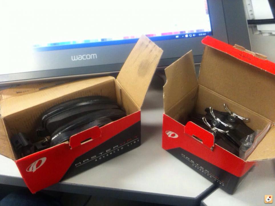

          After the anti roll bar, brake pads were the next step. I knew early on that I would be updating the pads pretty quickly so in anticipation I contacted Greg at GSL Rallysport for some QFM A1RM pads. Upon consultation, we decide that based on the weight of the polo and the development of their pads, Remsa were the pad to go for. Just before picking up the GTI, this arrived at my desk...
          So the day of reckoning finally arrives. After exactly 21 days of being on Australian shores, and the day I was due to head up to Yarrawonga, I picked up the GTI. At 5pm I drove out of the dealership to run in the car and bed in the brakes. After doing so I headed for one of my favourite stretches of tarmac for a shake down. I had limited time so it only involved the little hilly section of road at the start of my planned route. After the initial awe of the little rocket (I did come from a 1.6 Mk4 rally!) I noticed a flaw in the brakes. Even after bedding in as per my usual Stoptech method, the brakes were rubbish. So, after a bottle-and-a-bit of nice new fluid and the fitment of the Remsa pads, I headed out to my bed-in road. Initially, there wasn't much difference in the way the (it's about 25kms away) pads were performing. So, I started the bed in procedure. After A LOT of black dust, the stench of burning brakes and me feeling quite motion sick, I started the trek back home. Initially I didn't notice much. The pedal was a bit more responsive but nothing majorly noticeable. Then I hit a downhill section and the brakes started getting some heat in them and the change was phenomenal. Nothing Ike the factory pads!! The factory would bite but then require more pedal, then bite and need a bit more. The Remsa pads though, they bit and stayed biting!

            Hey Gavin, just a few questions about your brake pads/rotors...
            How is the brake dust (any worse than stock)?
            What's the stock rotor wear like with the remsa pads (I assume your running stock rotors)?
            And how many KM's have you gotten out of them?
            Also would you recomend better rotors to competent the pads?
            I know from my stock setup that the pads wear together with the rotors and both are replaced together at about 70,000-90,000km - so I would like to hopefully get something close to this.
            I'm getting a ECU tune once the warrantee is up next year and I wanted a good brake setup to go with that - allready changed to a low viscosity, high temp DOT5.1 brake fluid but I'm now due to replace my pads and rotors in about 7,500km and would like to get some stuff ready.
            Also you mentioned the QFM pads, any reason why they weren't up for the job and you decided to go with the remsa?
              Gavs Viezu Racing polo build
              I am running the stock rotors and the wear of them while worse than stock, to me is very acceptable. The QFM A1RM pads are much more aggressive on rotors than the Remsa pads, they also require more heat in them to work properly and are less street friendly in that regard, they're also more dusty than the Remsa pads.
              As limited a time I had the stock pads on, I remember the Remsa pads are less dusty than stock.
              So far I've done about 50,000kms on the Remsa pads an when I checked them last Friday for wear, I'd say there's about half the pads left and the rotors are down by about 0.75-1mm.
              As for the better rotors, I find the factory ones are pretty good but expensive from the dealers, so shop around. And in reality, the power and torque increase isn't going to be so much that the stock brakes can't handle it anyway so pads and fluid will be plenty sufficient.

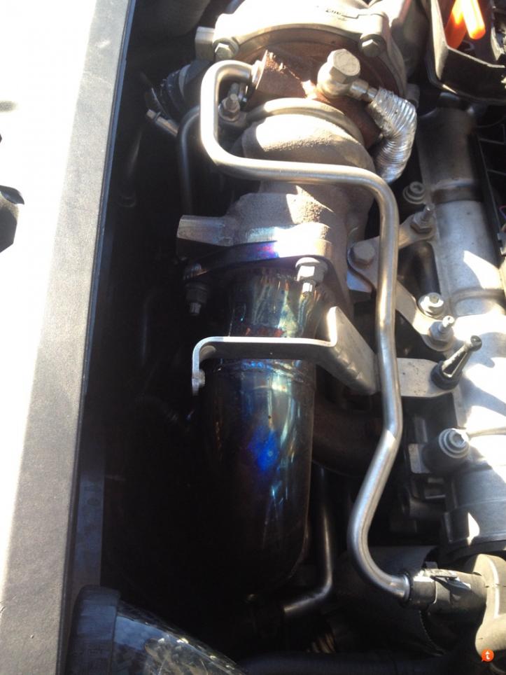

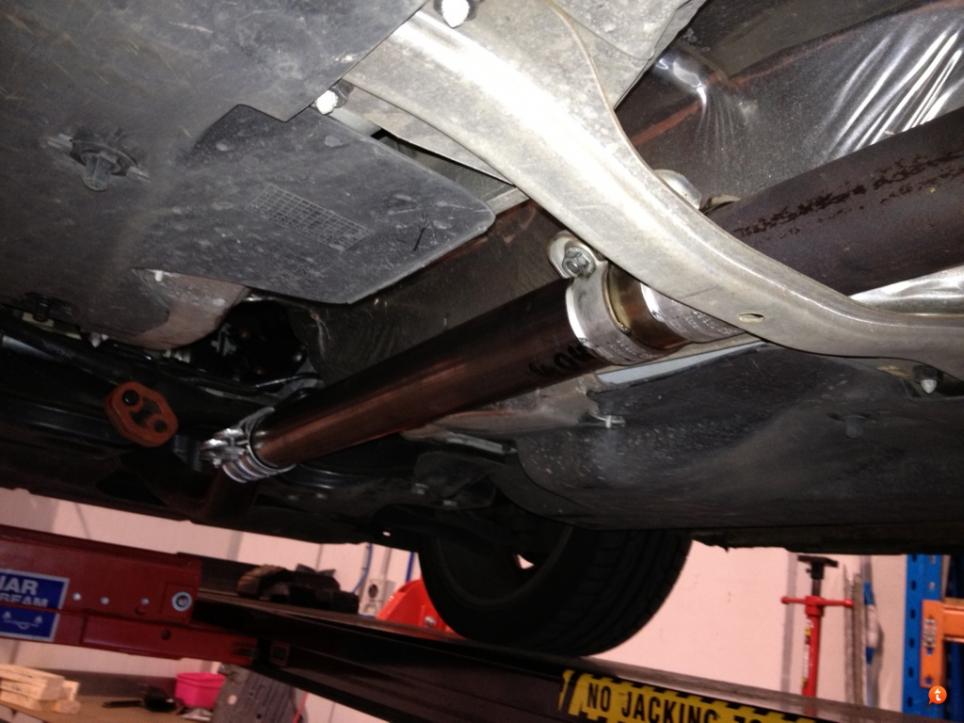

                  So, after the intercooler purchase I decided that it was time for some aural advances. The main goal was to get a bit more midrange noise and to unleash the dsg up shift ignition cut noise so, after almost losing a couple of digits, the result was this:
                  And did it work? Yeah it did! It made the car sound more like it should have from the factory but was it enough? Nooooooo...

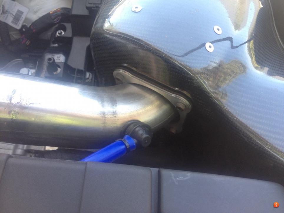

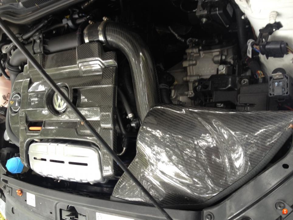

                        So, after further discussions with Simon at Viezu, we further formulated the plan. Update to software, production intake and exhaust...
                        Fast forward 6 months...
                        At this point the fastest time I had seen was 6.1, even though I felt the car got faster with the tune settling in. I sourced some new rubber after a very long debate and settled on the Bridgestone RE002. A fantastically grippy, yet also quiet and comfortable tyre, time for another test then but, before then I got a phone call, time to do some updates...
                          Ola carbon!!!!
                          At this point, we also had another goodie to go with it...
                          Ola stainless!!!!
                          The noise this little polo makes now is sublime. Not ricey, it has a nice little bassy-ness to its rasp. The turbo spool and dsg ignition cut are fantastic and even with the latest update to the tune which makes for better economy, fuel economy has disappeared!
                            I know that carbon engine cover doesn't really add any performance but I have to admit it looks good Looking forward to the day that I feel confident enough to mod my polo...
