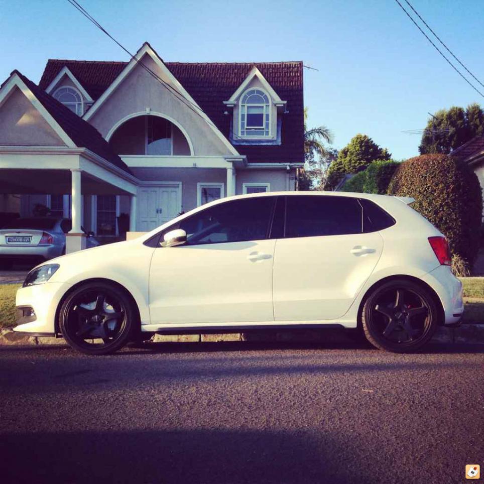

    Hey guys,
    Wondering what the stock ride height of the front and back of the GTI? I've been googling and can't seem to find anything.
    The Weitecs are scrubbing slightly at high speed when turning or during some bad roads at speed.
    Trying to figure out how much I should raise the car.
    I'll measure it tomorrow and see what it is now but I'm not sure how it's measured!
    Any help is much appreciated! Thanks guys!

        Ride height according to the technical specs is 351mm+/-10mm for the front and 367mm+/-10mm for the rear.
          Your car doesn't even look very low - its probably just the offset of your wheels that's scrubbing when you hit a bump or go through a corner fast.

            Can you explain what this means? And as the scrubbing is light and occasional when driving hard or bumpy am I at risk of much damage?
            My friend suggested raising it 5mm and seeing it it helps.
            Thoughts?

                Sorry - mabye i should have explained more clearly. What i meant was that its not like your car is super low/slammed or anything. So wondering why its scrubbing? Your aftermarket rims might not be the optimum offset (offset meaning how far they stick out from the hub) and this (combined possibly) with the width of tyre you are running might be your problem.
                Do you know what offset your rims are? And what width tyre are you running?

                  Thanks for the clarification!
                  I am on this I believe:
                  Tracer V1 18x7.5 5x100/114.3 42 73.1

                      depending on what size tyre you have, you could either be scrubbing on the arch lining near the center screw at the top of the arch, the inside front of the lining (i.e. inside of right wheel when turning left) or the protrusion where the front bumper meets the arch (there is a small protrusion and i believe a screw holding the two together. (i have recently found this point to be what is chewing the very outside corner of my tires. this should be fixed by either raising the car a little (boooo!!) or changing the tyre size from a current 215/35r18 to a 205/40r18. the small amount of extra stretch will provide more clearance, or removing the 10mm spacers)
                      i would suggest jacking up one corner, removing the wheel and checking the lining for scrubbing, once you have found this, the solution may become clearer
                      for reference my setup atm is 18x7.5 et28 (all-round) front sitting (if i remember correctly) 595-605mm

                          i have scrubbed all wheels somewhere at some point, so i know how you feel every time you hear it lol. the other guys should be able to provide some help at the meet, or at least give suggestions. and keep the rake!! its what you want, just make sure the rear is never lower than the front (known as commodore stance, or commorake and not what you want on a euro... or anything really lol)

                            Haha so "rake" means fronts lower than the rear?
