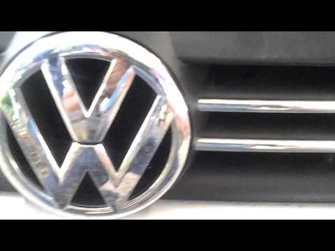

Based on research i've found
Front VW Emblem:
Method 1: Removal of the whole front/honeycomb grill and then taking out the emblem by turning either clockwise or counter clockwise
Method 2: Without removing the front/honeycomb grill, turn the emblem counter clockwise or clockwise.
Rear VW Emblem:
Method 1: Flip up the badge, there is a small space/gap, use a fine flat head screw driver and then carefully pry it off, be weary of the tabs/clips that hold the badge in place, you'll have to bed those tabs to get the badge off.
Method 2: Do the same as above, using an old credit card (pictures in the links above of this being done).
