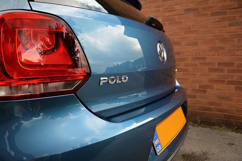

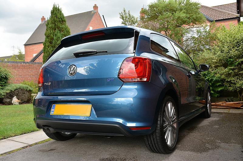

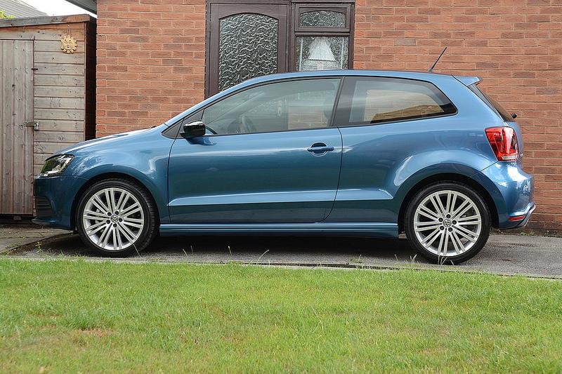

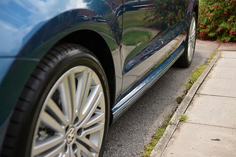

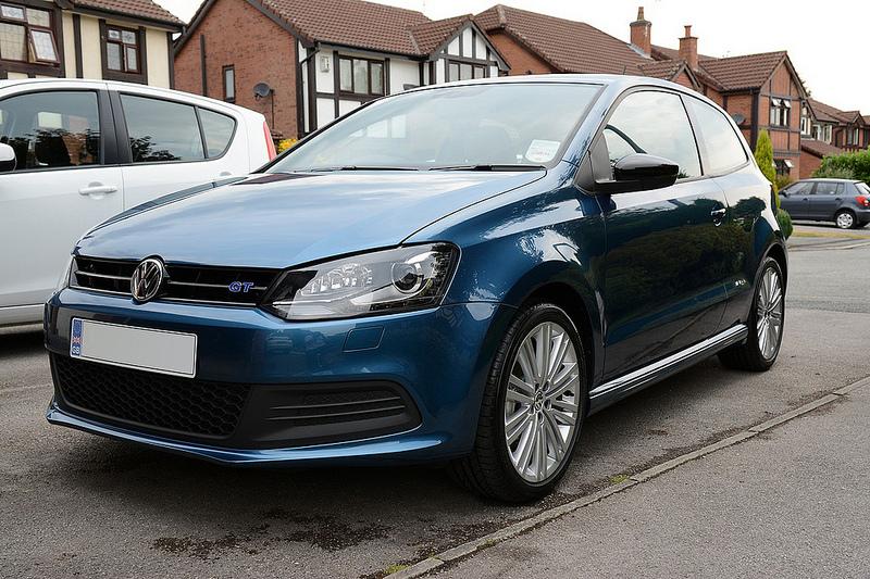

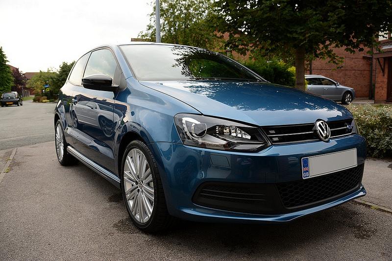

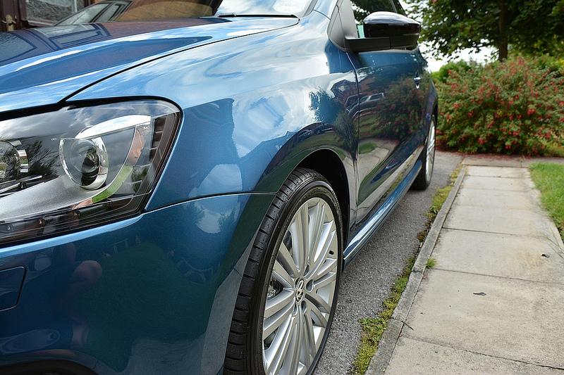

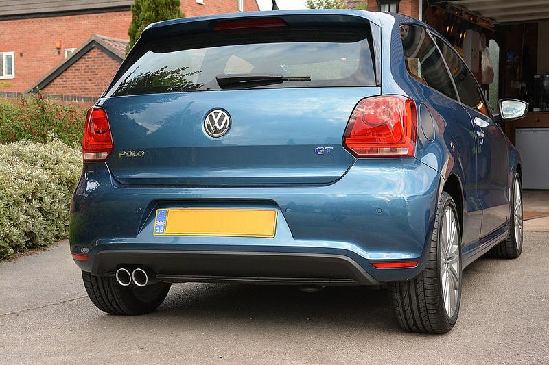

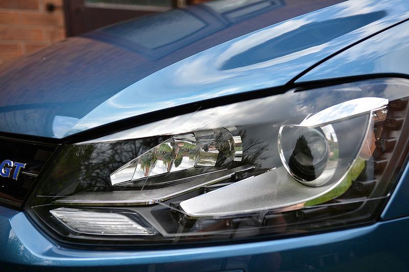

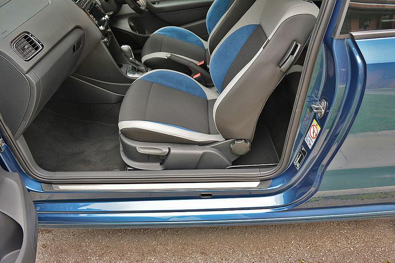

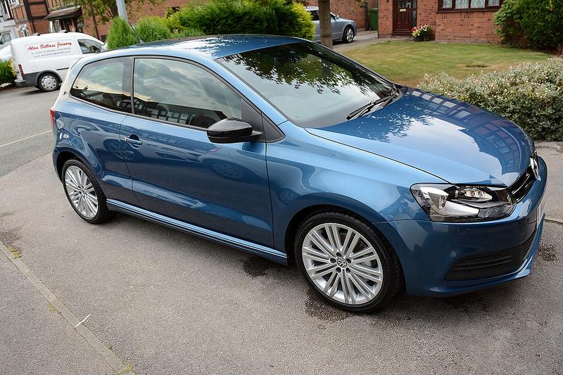

Hi all, as promised from my thread a few weeks ago, on Saturday we picked up the wife's new Polo Blue GT, and an absolute cracker it is. We asked the supplying dealer not to prep it in anyway, and whilst a little dismayed, they stuck to their word and Whilst the car was dirty (having been in their compound for 3 weeks as we were on holiday), it was pretty much mark and swirl free, although the paintwork did feel like sandpaper
No before's I'm afraid as I only had the weekend to get it prepped and cleaned as well as carry out some modifications before the rain was due to arrive on Sunday afternoon.
Method
Power washed to remove as much muck as possible.
Snow foamed using AF foam and left to dwell for 15 minutes whist I worked it in with a detailing brush in the nooks and crannies.
Rinsed, then washed with TBM, using Megs shampoo. Car then rinsed and then clayed all over (including windows) using bilt hamer soft clay using Megs last touch as a lubricant.
Washed again and rinsed. Complete car and wheels coated with Iron-X which removed vast amounts of fall out. Rinsed, then sprayed with Tardis to remove transport sheet glue and various tar spots.
Car then finally washed again and dried with my big thick drying cloths.

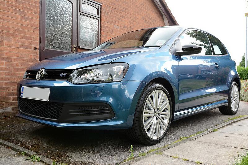

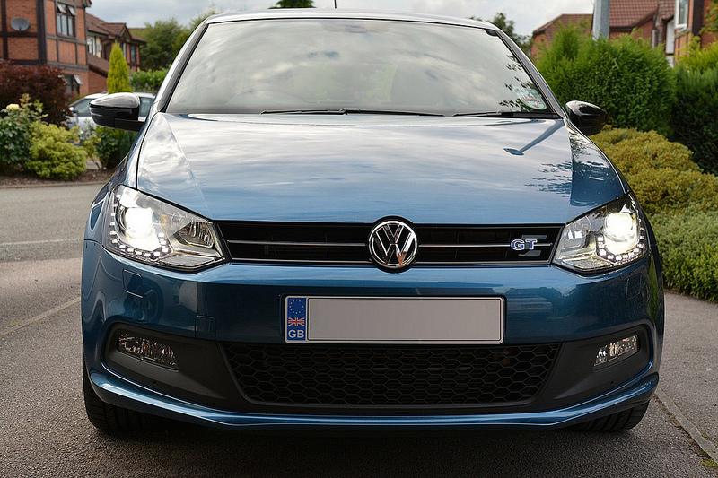

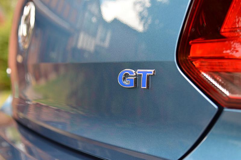

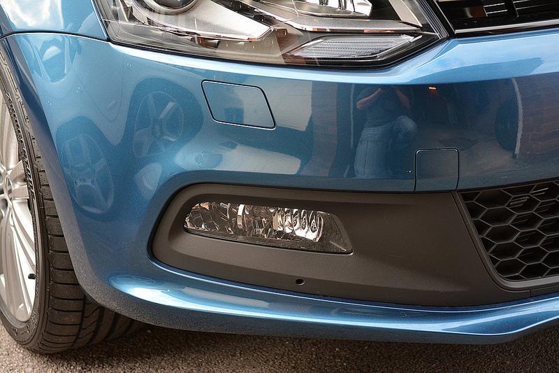

Paintwork was inspected and to my surprise, it was in really good nick with no scratches or swirls at all.

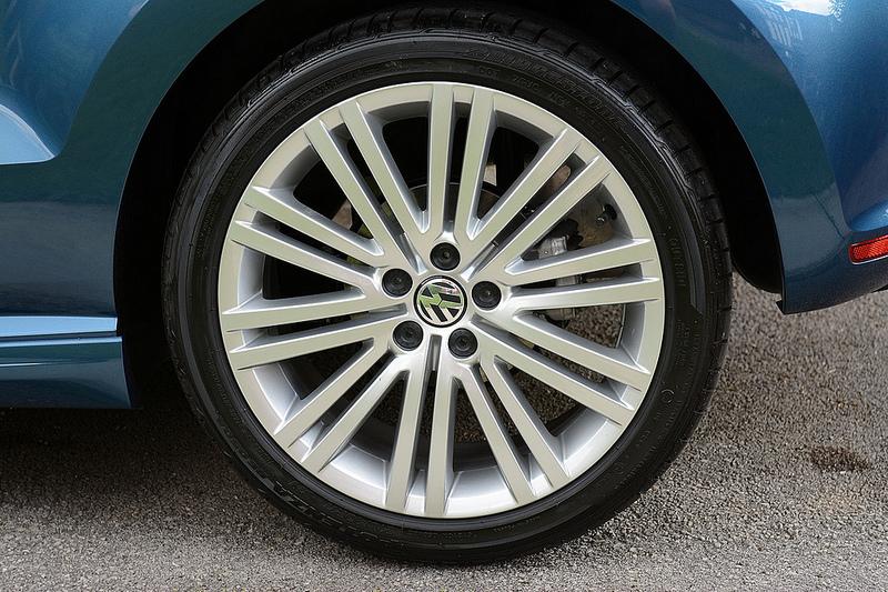

Went over the car with AF Tripple on a foam applicator pad, then gave it coats of GTechniq C2V3 Liquid Crystal (including alloys which were removed to seal on the inner faces). Trim dressed with Aerospace 303, and tyres with megs endurance tyre gel. Finally windows cleaned with Autoglym Fast glass inside and out.

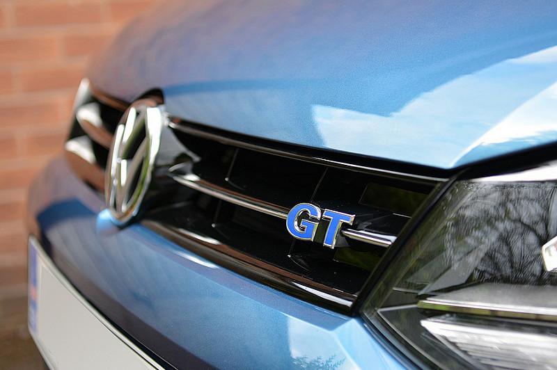

So, onto the pictures (sorry, got a bit carried away).
Outside
AGE_0235 by Sootchucker, on Flickr

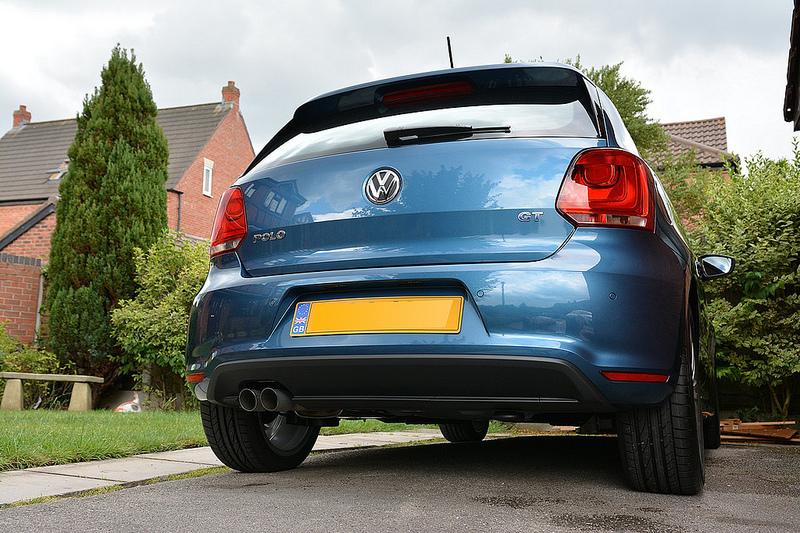

AGE_0238 by Sootchucker, on Flickr

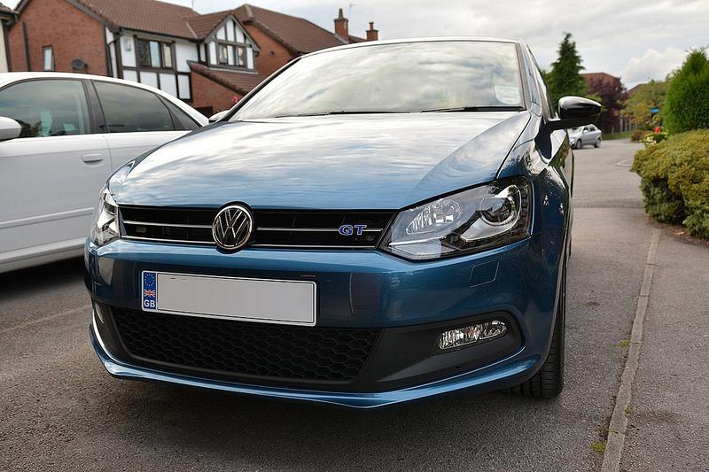

AGE_0241 by Sootchucker, on Flickr
