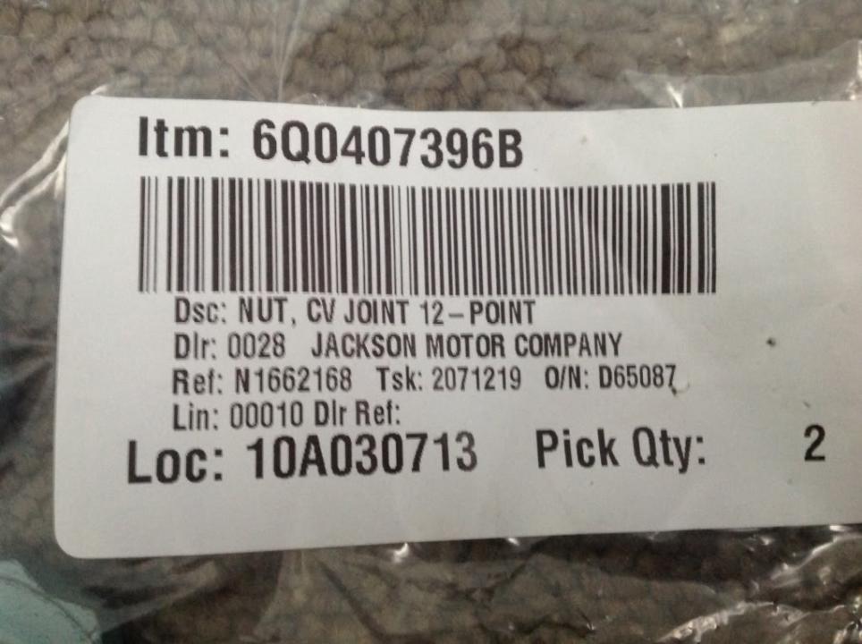

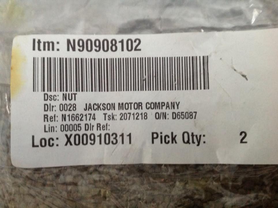

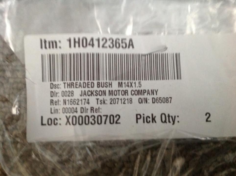

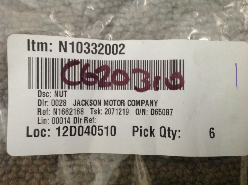

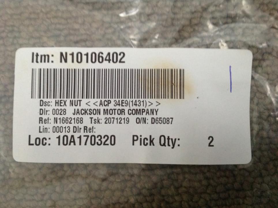

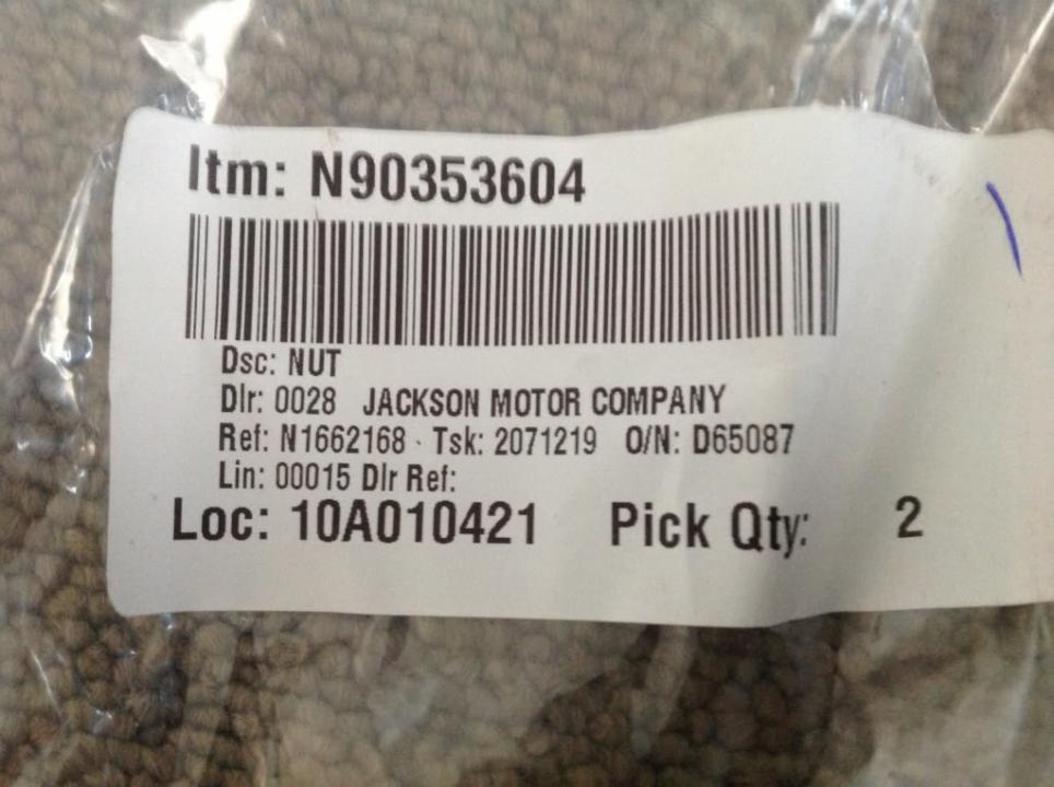

        There are also some one use nuts and bolts you will need to buy pictured below.
        The last two rant needed if you don't remove the shafts.
